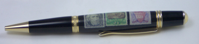

Earlier this week Glenn McCullough posted a pen made with a stamp blank I cast for him. It can be seen here: http://www.penturners.org/forum/showthread.php?t=48775 That blank was cast without pressure and was cast in one of Newlondon88's resin saver molds. Later this week I made some snake skin blanks without pressure or vacuum using the resin saver molds and also using the molds made by gadget. All 8 sets came out flawless.

Originally, I had no plans for doing any casting, but I found something I think would make an incredibly cool pen if I could bring it off. So, I started to explore the subject here at the board.

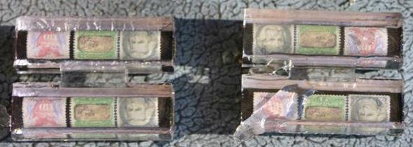

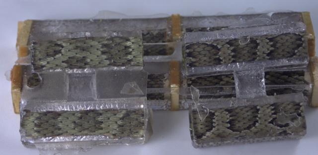

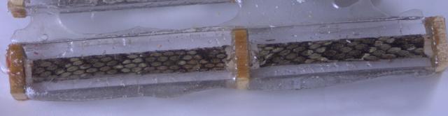

Sorry for the delay but I was sidetraced over the weekend. Here are some pictures I promised. I'll try to get a snakeskin turned and post a picture in a day or two. Thanks for looking and commenting.

What do I do to the skins? I paint them with raw polyresin as I place them in the mold...a good soaking. The theory beign the PR soaks into the skin and displaces any air that is in the skin. I leave the skins to soak for about 10-15 minutes before I pour the catalyzed resin into the mold.
If you read my snake blank article and remove the parts about pressure and vacuum and add what I've mentioned here and in this thread, then you know how I've cast the last few batches. Reply back if you need more questions answered.

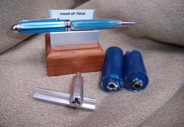

Ok now along comes Peter with a hint of something we or maybe just me haven't seen yet.:eek: What is that in the center of the blank Peter, inquiring minds want, no need to know.:confused:.
Don, I was encouraged by your post to try to cast without a PP and this is what came out. Surpringly no air bubbles!!!! I still will keep my PP to do my grooved/slotted wood and PR combo pens. The high pressure from the PP helps the resin to seat in the slotted grooves. Guess I will continue to use both methods (w and w/o PP).
Sorry to post so late Roy. The centre is aluminm. Turns like butter when carved with a SKOGGER. This was my first taste of turning metal and now I'm hooked. It's getting bad for me: I started with wood (exclusively), tried and like PR and now comes steel. This addiction is killing me. So many materials to turn and yet so little time.
Sorry to post so late Roy. The centre is aluminun. Turns like butter when carved with a SKOGGER. This was my first taste of turning metal and now I'm hooked. It's getting bad for me: I started with wood (exclusively), tried and like PR and now comes steel. This addiction is killing me. So many materials to turn and yet so little time.
Peter, you're killing us!! What is that extruded shape called? Where can we find it? I'll give you a shiny, new nickel if you tell me... :wink:
