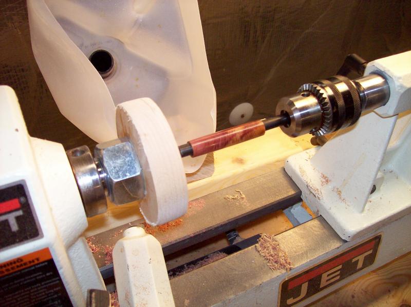

I know there have been several threads on squaring blanks and also cleaning up the ends of a finished blank to get the excess CA or other finish off the blank. I still use a pen mill when I have a lot of trimming to do but I use this home made set up for taking off just a little wood or for removing that annoying bit of CA on the ends after finishing the blank. I was to cheap to buy another gadget and didn't have the patience to make sure my disc sander table was square to the disc. So I made this. I already had everything except the hex nut (1 X 8 for my Jet). It is just like what many do on the disc sander but is on the lathe. I like this a lot because it is quickly removed and is always square when mounted again.

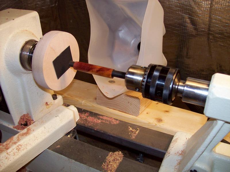

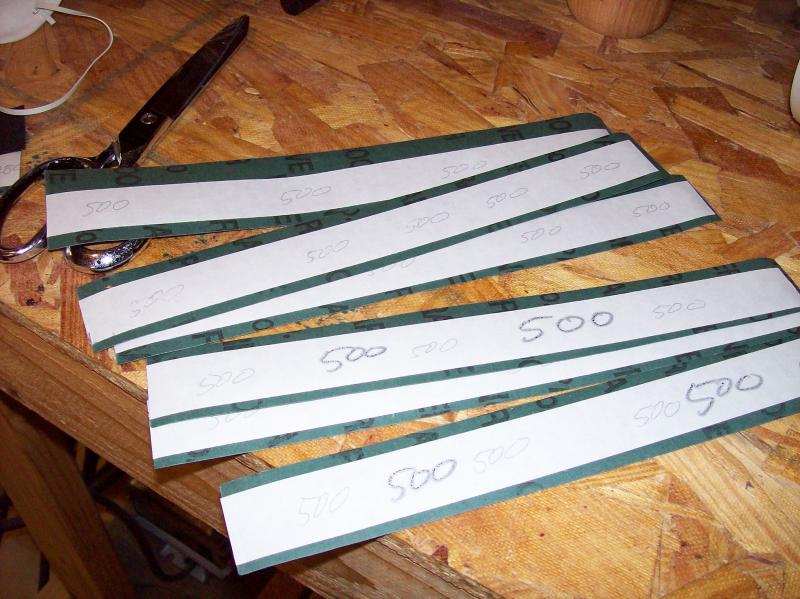

This was very easy to make. I roughed the hex nut with sandpaper and glued (thick CA) it to a scrap piece of wood. I also ran a bead of CA around the hex nut / wood joint and sprayed with accelerator (I didn't want to get it glued to my headstock). I mounted it on the lathe and knocked off the corners. Then I trued the surface using a fingernail bowl gouge in a scraper position. This was the most time consuming part but still only took a few minutes. I placed my Jacobs chuck in the tailstock with a punch from my HF set. The little black square on the wood is the sandpaper. It is held in place using turners tape. I make these in strips a little wider than the tape and cut them into squares. I make the strips in several different grits.
To use just slide a blank onto the punch and slide the tailstock up so the punch is close to the sandpaper. Turn on lathe and slide the blank into the sandpaper while holding it against the punch. It's so easy I don't bother locking the tailstock. I just hold it with one hand and slide the blank with the other. A few seconds and the excess CA is removed. The sandpaper peals right off and is quickly replaced.

That is very clever. I also use the lathe for most of my squaring. However, I chuck the blank into a 4-jaw and then face-cut using the skew. If I'm cleaning up the edges from finishing, I use the barrel trimmer. With the barrel trimmer, I never have the right sized center on it, so I'm sure it doesn't help me.
I think your idea is great for doing both effectively and quickly.
Great idea!
One caution --
CA glue is brittle -- one sharp blow will cause it to crack/fail and it then could be a thrown object. That brittle nature is how some mount bowls on blocks and separate them with a sharp blow. Seen it happen -- S0- drill a recess for the nut and use epoxy to have a better mounting that will not be as likely to become a high speed thrown object.
One suggestion for improvement -- get the "nylock" nuts with a nylon locking ring. I heat the ring with a propane torch to soften the nylon and pull it out with a small dental pick. That space allows the nut to bear against the face of the headstock and not bottom out on the end of the threads. (also called relieving the threads) an will be a more lathe friendly mount. I will grab some photos.
Great Idea!!! The above are suggested improvement on a good practical approach.
Eric - You won't believe how fast and easy this is for cleaning up the edges after finishing. Literally about 1 or 2 seconds with a light touch on each end of the blank. For squaring a blank it doesn't remove much material since it is using such a small piece of sandpaper. However, i find it hard to use a barrel trimmer and remove just the right amount of material to get it exactly where it should be in relation to the tube. This is a great tool for removing that last 1/32" or 1/16" of wood to get it perfect to the brass tube.
Rob (or anyone else) - feel free to copy. You might want to use 2 part epoxy instead of CA. I think the epoxy will probably bond the hex nut and wood better. Also, if you plan to make a larger one for heavier sanding (like a disc sander on the lathe) you shouldn't just glue the hex nut to the surface. You should use a forstner bit and drill into the wood a little so about 1/2 the hex nut is into the wood. When you glue it you should also fill the gaps. This will give it added strength and still allow you to grab it with a wrench if you need to.

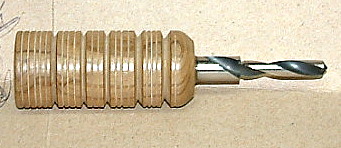

About fifteen years or more ago certainly in the mists of time here in Australia the only Barrel Trimmer available was a Step Drill that cost me over 20.00 dollars. please find a pic of my orinal Step drill made for Slimline Pens. It has been used for a tremendous number of pens and since I have a percentage of Irish ancestry am currently getting one ground from a 12 mm drill in the USA to have a spare to be sure to be sure. Current pricing around double my original. people used to use them in hand drills but I feel you lose the sensitive feel needed for some timbers hence it is housed in a handle.

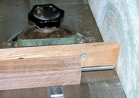

For a squaring jig I use a 1 1/2 inch square 4 inches long, centre drilled, fitted with a cut off mandrel pen blank slides on. The block of wood with the mandrel is at right angles to the disk sander gently faced.
