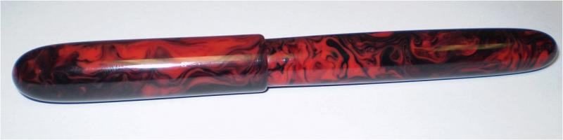

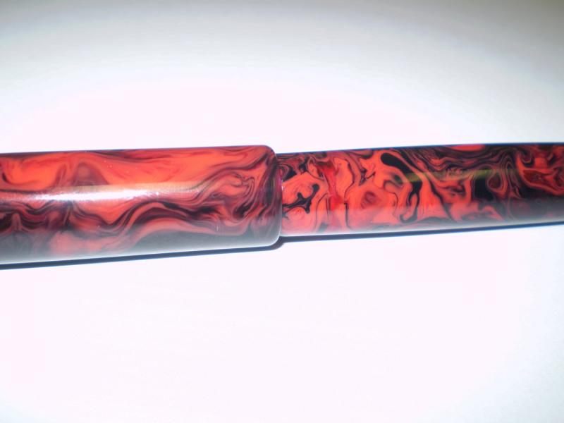

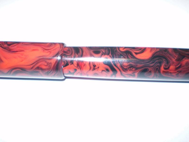

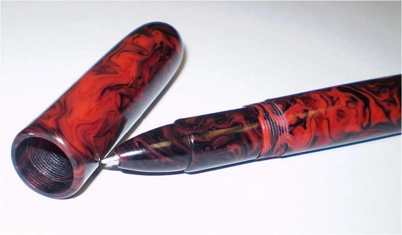

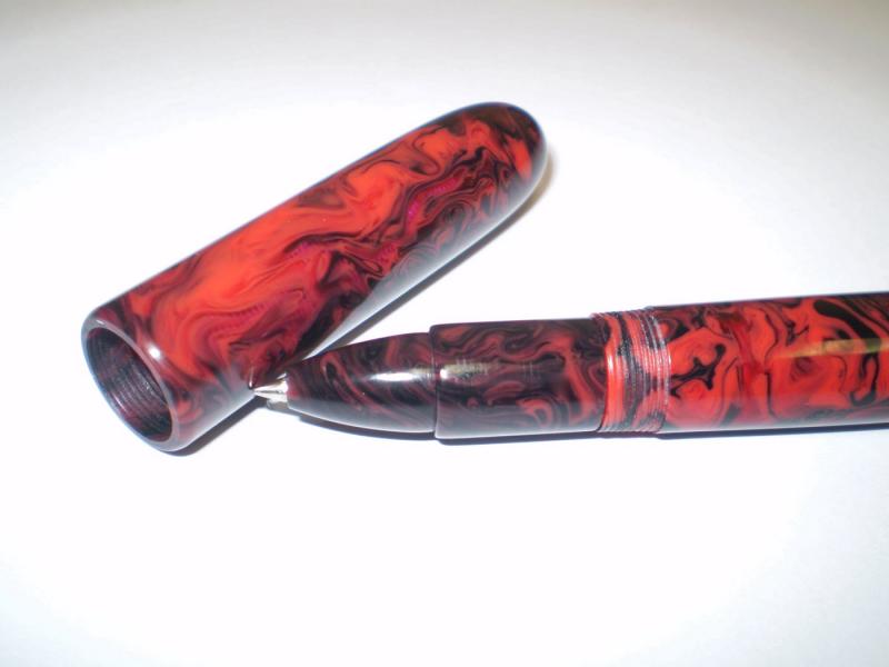

This my latest no kit style pen using Charlie's (NewLondon88) Dragon's Breath blanks. The pictures really don't do this material justice. The swirling is pretty cool in person. It turned, threaded and finished fantastic. I took some sage advice and made my own RB nib on this one using the same material. I was trying for the Think style pen look, but not bad for a first try. Next time some brass or aluminum mixed in I think. Any and all questions, comments, fart jokes welcome.

Looks nice, the nib is a great touch. The blank is cool! I see a face just below the nib threads - sideways with the eyes closest to the nib and a smiling mouth towards the bottom.

Cris, lookin good over here in hotter than heck, Texas. Nice touch on the threaded cap and nib. Yup, hard to describe and show justice to the blank for sure.

Sweet.... What threading did you use on this one? Triple start or one of the Fine singles?
Mike,
I am kicking myself for not jumping on the Group buy, but I couldn't swing the cash outlay. I use a 1/2 x36 tap and die fopr the cap/barrel and the M 10x1 for the threaded tenon on the nib. It's a single start, but if you ream the thread out just right, you will be able to eliminate the 4,000 turns to close by at least 3,994 or there about. This one closes with 2 turns.
