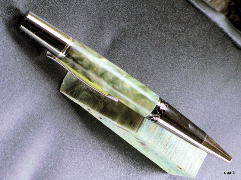

It works-----Like many other folks I have tried just about everything on earth to make soft punky blanks useable. The search is over, Ultraseal Wood Stabiliser works.
If I wanted to find fault---I think more emphasis should be made on safety----wearing gloves---well ventilated work area. I would not use this product insde your home.
Blanks do have a long curing time before they are dry---you aint using the blanks the same day you process them. They take several days to cure.
Bottom line---as soon as I can find the money I am buying some.
The blank is dyed Buckeyed Burl with just a drop of green dye. I wanted to see if I could pull dye all the way through the blank.

thanks for the review Gary...!...glad to hear it works.
