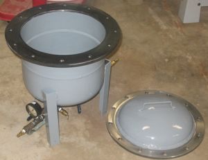

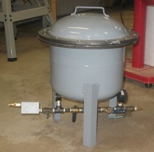

Oversize Vacuum/Pressure pot
I made a vacuum/pressure pot using an old propane tank that I could not get filled without replacing the valve. I simply cut the bottom off, welded on two flanges and added the fittings on the top which is now the bottom.
I had to paint the inside of the tank. No matter what I did I couldn't get rid of that awful propane smell.
I see the flange, but how do you lock the top to the pot? Screws?
There is an upper and lower flange. I drilled clearance holes in the upper flange and drilled and tapped the lower flange. I made my own winged bolts that can be also tightened with a wrench(not in the pic) I also cut a large rubber gasket out of a sheet of rubber I had.
