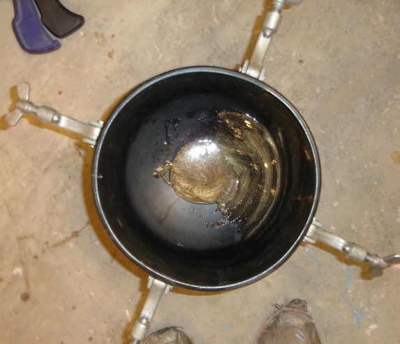

I put my molds that took a long time to make into the HF pot. Tightnend the screws down nice and tight as usual. Applied 50lbs and walked away. Not 2 minutes later and boom, the lid blew off.:eek:! 12 ounces of resin everywhere and the molds are junk now because they have bubbly resin partially in them. The lid is perfectly fine, can't see a thing wrong with the lid. The bowl itself is shaped like an egg. Somehow the side walls expanded out. Don't know what happend, but HF won't replace it, I tried that, but the pot is 6 months old and they warrant it for 90 days. Sucks to be me.
Did you have a pressure relief valve? Did the metal in the tank fail? I hope this doesn't happen often. My Harbor Freight told me the warranty ended as soon as I replaced the hardware with newer stuff on mine so I didn't buy the extended warranty. Man that sucks but I am glad you weren't standing next to it.
Wow! Sorry. Would love to see some photos. I brought my pot in last night because it so cold outside. My wife would kill me if it went off on her kitchen countertop.
There's not really anything to see but a gooey mess. The clamps did not break, and no I did not have a relief valve, but the pressure wouldn't have set the valve off anyhow as it was only 50lbs. The pot didn't blow across the room. The lid is in perfect condition. The bowl broke. It didn't break in half, it elongated and crushed at the same time. Basically if you pick two opposite sides inbetween the clamps, it stretched there and the two opposing sides caved which caused the lid to pop off. The entire pot probably jumped a couple inches as it landed on it's side with the lid off and all the contents oozing over everything. I wiped it all off the counter as good as I could and cleaned the lid off. The bowl is warped out of shape. All I can figure is I need to buy a new pot, then use the new reciept to get a new bowl for free? They don't stock the bowl portion of the pot, it's a 6-12 week order. I tried using a clamp to fix the bowl back to being round, but it won't go, and probably better that it doesn't.
I think that you should not concern yourself with ways to get HF to replace your pot. Realistically, the moment that we alter the pots to conform to our use, we invalidate the warranty. There is no reason for any of us to expect HF to replace a pot that was damaged by our use.
What I would concern myself with is the cause of the failure. Personally, I suspect that your regulator allowed much more pressure into the pot than you think. Since you had removed the safety valve (invalidating the warranty), the pot failed.
If the pressure guage is bad and there was not relief valve you could have had a lot more pressure that you thought. Is this the first time you have pressurized it? Just a thought.
Whoops somebody beat me to the same thought.
The pot is supposed to be able to handle 80lbs. I have my compressor itself set for only 60, I have an air dryer set on 60 and the guage on the pot said 50, as I didn't pump it up to 60 which is all I had everything set too. I doubt all three guages are incorrect. I have never dropped my pot either, and I have it marked to always put the lid back on the same spot every time. I took a picture of the now deformed pot. It's tough to see being black and all, but the rivets/weld where the clamps attach on two opposite sides are bent inside the pot. Looks like they where trying to hold on but as the pot bowed out, it pulled on those two sides as they bowed inwards. I have only used my pot about 20 times. I wonder if it might have been slightly out of round to begin with and over time just got worse. It's completely possible that it was defective from day one. Nobody will probably ever truly know. No harm done anyhow.

Here's a question and a wild, hairy guess. Was it really cold when you started the pressure and had you completely sealed off the valves?
Since it seems unlikely that the pot would blow at low pressure of 50 psi then how would it get higher? A theory, cold air in a sealed container gets warmed up by the setting resin. Air expands increasing the pressure.
Seems far fetched but so does the pot blowing at 50 psi.

Man that looks egg shaped all right - it looks like you broke the yolk...

FWIW - I had a friend who could never get his HF PP to work correctly so I offered to take a look at it for him.
Took me two seconds to find the defects around the anchor points for the lid latches. Upon removing the lid it took me another two seconds to see the pot had been deformed and was no longer in-round. We pulled the gauges and piping and it's now a flower-pot. He got his next pot from Grainger and he has never had an issue with it.
Always check your equipment and make sure you have the proper safety precautions in place. As pointed out - the PRV is a critical piece.
This could have been much much worse.
I bet the pot was deformed from the start.
A circle is a very stable shape. As long as the pressure pushes out evenly from all directions it will remain circular.
If you start with an oval, just slightly, the pressure can cause the widest point in the oval to continue to get larger. It may be a very slow process.
So I bet the pot was an oval to begin with, and just kept getting wider and wider as you did cast until critical failure occured.

Oh no worries. The lid looks fine, but it is not. It is warped pretty darn good!!! Amazing what 50lbs of pressure can do, and that's no joke!

Guage is good and threads on clamps are fine Darley. The pot just looks like I pulled it out of the Laurentian Abyss is all. The stretching and squeezing of the pot caused the clamps to pull right over the lip of the lid. The clamps being pulled over the lip cause the inside where the clamps are attached to the pot to bend a bit. Besides...if my guage was bad, by compressor was set and my air dryer set to only pass 60lbs of air. Also, my compressor is not capable of exceeding 100 lhs of pressure ever. I'd have to hook the pot to my Semi-truck to go higher. And..I just sqeeze the trigger to fill the pot for about 20 seconds then check guage and maybe add a bit more. To pump a pot to 80 lbs with my compressor would take a good minute at least. It's a bad pot. I was in the shop, just not on that side of the shop. The shop is plenty big.
Jeff the best thing you can do is to trash the whole pot and get another new one and start again from square one would not event re-used any fittings life is to short to try to save $$$, hope this little incident deosn't deter you to do more casting, we do learn do we.
