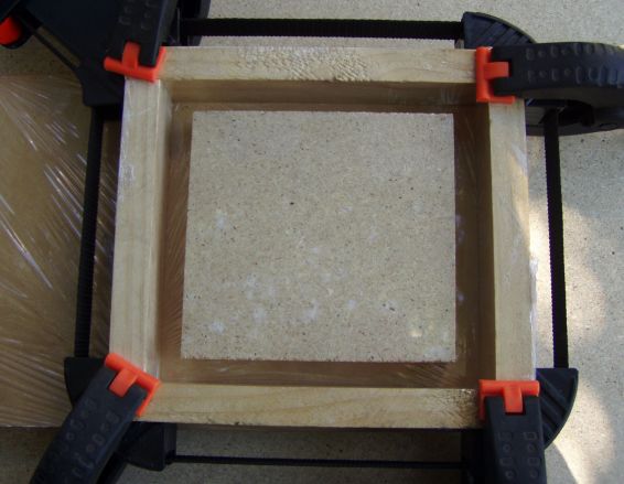

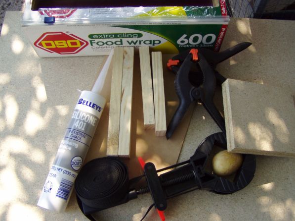

Material:

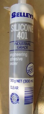

2 RTV cartridges silicone (300 grms each) "standard acetic acid cure silicone caulk." It smell like vinegar, the one you use in the Bathroom or wet area or you can use the 2 pour RTV, but more expensive. If you can't get any RTV cartridge near by just drop a line to Matt aka Gadget he migth help you with some 2 pour RTV.
Clamps
Strap clamp

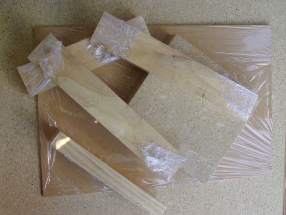

Wood 'Master block 'this will define the size of your casting blank
Wood frame
Glad wrap / Saran food plastic film
Wood or corian board here I use an off cut of 3m/m MDF
1 Potatoes :biggrin:

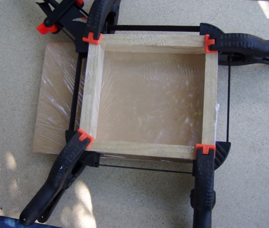

Cut all your wood to size for the frame here I'm doing a 1" mould by 5 1/4"x 5 1/2" ( size of the master block ) I will have then 5 blanks 1" x 5 ¼" . The wood frame is 2 length 6 ¼" x ¾" thick x 1 ½"high and 2 length 8 ½" x ¾" thick x 1 ½"high , Wrap all your wood pieces including the 3 m/m MDF base with glad wrap ( saran ) then make your frame.
Secure the master block to the board with double side sticky tape

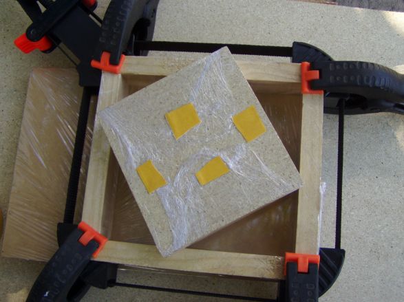

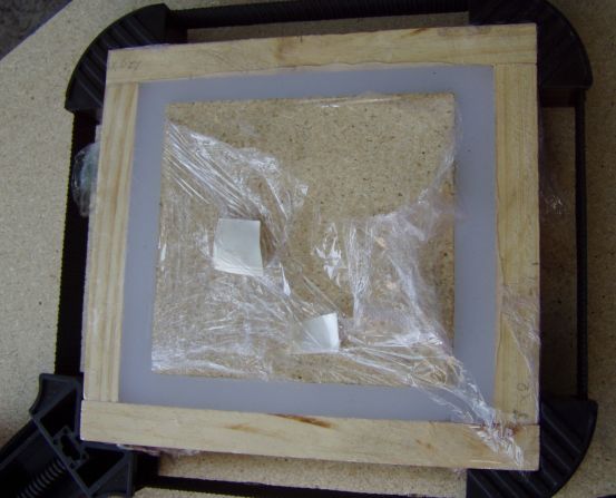

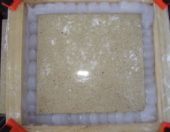

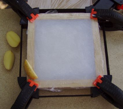

Cut the RTV nozzle cartridge to a wide opening and start the edges while holding the master block, make sure that the nozzle is in the silicone to prevent air bubbles, cover the top who will be the bottom of the mould and smooth the edge with the potato ( silicone doesn't stick to potato starch ) then cover with glad wrap to smooth the surface and let it cure 24 hours.

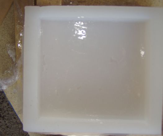

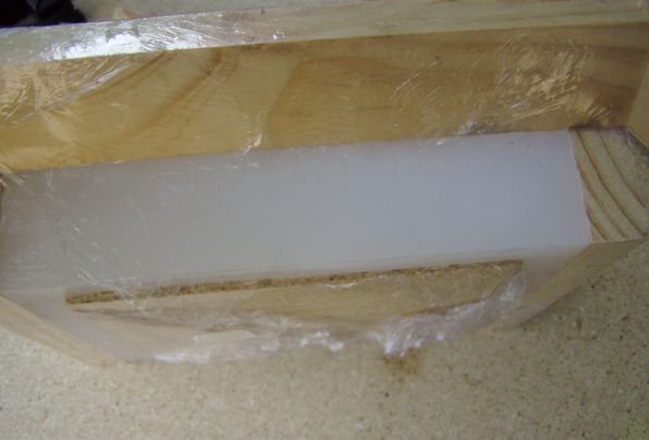

After 24 hours you can undo the frame and peel off each side of the mould, you have to go very easy as the silicone still fresh and can be tear easily
Base removed ( nice smooth edges )

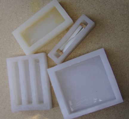

Let cure the mould another 2 days before use, here are some of the moulds I made
Happy Moulding:biggrin:

RTV, caulk is the stuff you used to seal the bathroom with, it smells like
vinegar. It's cheap than the 2 pour, you can get it at any local hardware store, I use the clear, but any color will do, just so long that it is
the acetic cure (acid cure ) and not neutral cure. Neutral cure
silicone caulk is too flexible and your mold will fail, the weight of the resin will
cause the sides of the mold to bow.Acid cure silicone caulk, is what is called a moisture curing caulk.

Neutral cure caulk could still be used, but you would have to keep the mold in the box when you poured your blanks or create a 'mother mold'. Either way is pretty easy, but a mother mold would fit in the pot better.
I believe that is the kind of silicone used in fish tanks, if so try the local aquarium supply. You can also try making the master compleatly out of corian glued together with ca. Thats what I use however it is hard to get the cured silicone out. Compressed air gets them out enough to pull the rest out. I use a pourable silicone mixed like epoxy. pourable silicone is great for molds but verry expensive. I can try to package this type of silicone for you guys. Being that I buy it in bulk maybe i can get the price reasonable enough to benefit everyone. It does have a short shelf life so it needs to be used within a month. I think that Darley did a good job for those of you that want a specific size mold and like doing it yourself.
Go to www.amazon.com and search for "RTV silicone". I found one offering of a 10 oz tube for about $3, by Small Parts, Inc.
Also check eBay. Someone is selling 2 tubes of Dow Corning 732 RTV sealant for $6 plus shipping.(as of 26 Feb)
Read more about Dow Corning 732 here -
http://www.specialtyadhesives.com/dow_sealants/732_multi_purpose_sealant.pdf
Went to every store in town - noone's ever heard of RTV caulking...we have Silicone, Silicone 1 and Silicone II...whatever that means!
That's the stuff.
Just make sure it says silicone and not 'siliconized'.
RTV just means room temperature vulcanized.. that means it doesn't need
a heat cure.
I picked up bunches of it at a department store for about $3 per tube. It
usually says 'kitchen & bath' on it. I think it was GE brand, but not positive.
Most often it is in a red and white tube.
Silicone Caulk runs a wide range of prices so if the first tube you find seems expensive keep looking. Last time I bought some I got it for as low as $3.00 or so a tube. Just make sure it has the 100% silicone one it. Also be ready to have ventelation. the fumes will not harm you but they certainly will offend you.

effect as from a silicone RTV, so you need to take care to level the mold
box as well as the caulking itself. Otherwise, you turn the mold over and
pour your resin into a mold that is tilted .. and you can't get square
corners! If your mold box is square and set on a platform, you can use
shims to make sure the box is level. Then you can 'eyeball' the caulking
and level it.
