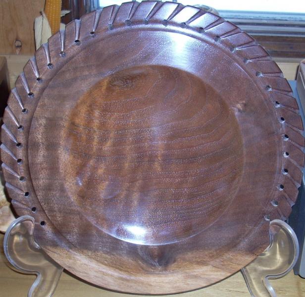

I think sometimes we get toolitis..we think this tool or that tool will help us make stuff..this plate was made with a smallish lathe, a handrill and some chainsaw files...have fun with your new shop & tools
Nice looking bowl. I may someday have the skill to do that with a handrill and a chainsaw but knowing how "delicate" my touch isn't it will be some time. I do admire that kind of ability.
