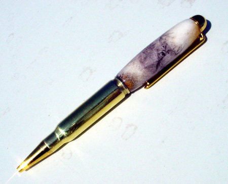

First attempt at using photoshop to simulate scrimshaw with decal. Slimline kit with .308 cartridge and euro finial. Antler with decal on top. Drilled out cartridge and custom fit wood/tube in the bottom. Picture is terrible.... taken on the hood of the car before I gave this to a friend in the hospital.

Paul,
There's a CA finish over the decal. The decals I'm using are the Testors decals that you print yourself with an inkjet. I've only done a few decals and it's a little tricky getting the air bubbles out.

Awesome idea. Does the actual pen have the same ghosty quality of the image that the picture shows (which I actually like)? How pronounced is the edge of the decal once finished (or does it show at all)? Great looking pen.
Steve,
After putting a CA finish over the decal you can't feel the decal at all. I'd be glad to send you a few decals of the deer head for you to try yourself. It's pretty simple. The hardest part is sizing and getting the printer to accept the decal paper.

Beautiful pen. I am getting ready to make my first cartiridge/antler for my brother. Where did you get the deer artwork?
Did you use the Testor's Bonding spray also or just CA?

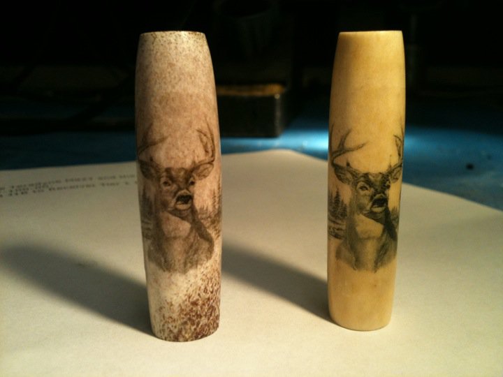

Decal update
I just wanted to add a little trick for getting all the air bubbles out. If you are lucky enough to have a soldering iron that is adjustable set it to low(300)heat. Using a clean part of the soldering tip gently rub any areas that aren't perfect. My experiance is that this works everytime. Another poster mentioned that you can poke a hole in the bubble and use a hair dryer/heat gun to get rid of the annoying bubble.

Do you need any special kind on software other than photoshop?
Anyone that knows how to print can do this. You just need the Testors decal kit (with spray). I used photoshop to tweek the photos darkness and microsoft publisher to print several pics at once. You really have to watch losing resolution when you resize the photo. For some reason when I use publisher for resizing the pictures still print fine. If you can't seem to figure this all out and still want to try then PM me and I could send you some decals ready to go. Trade? I could sure use some empty .308 cartridges. Here's a link to the testor products. Here in Oklahoma I bought the kit at Hobby Lobby.
