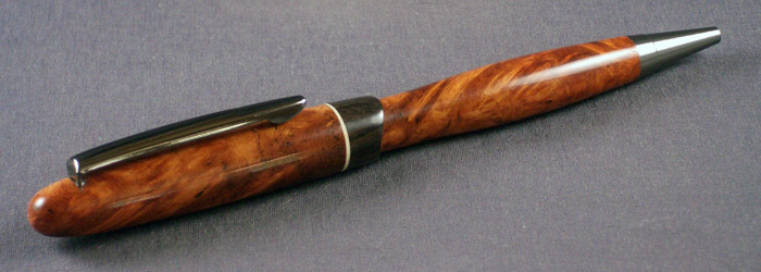

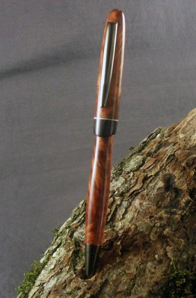

This is last nights work. I tried a couple of new things with this pen, This is the first hidden/inset clip I've done. It was a bit nerve racking but I think it turned out pretty well. I've got to improve my technique a bit as I think the clip opening is a little bit 2 wide. Its also the first time I've done a shapped center band. Instead of the center band going straight across where it meets the lower barrel, it curves up just a bit on the sides.
The pen is made with Afzalia Burl and ebony. There is a small strip of holly separating the afzalia and ebony. The finish is CA MM through 12000, EEE, and renwax. The kit is a slimline/streamline.
Comments, critiques and complaints always welcome.

I really like the look of that pen, which says a lot because I generally hate slimline pens. It's very clean, very classy looking. I think you did a great job. I really like the centerband too, that's a really neat look. Did you come up with that or did you see it somewhere else first?

Sorry...I mis-read about the clip, thought it said it was recessed. It's an awesome pen. I haven't done the hidden clip, just the recessed clips. I'll have to give that a go sometime soon.
A little of both. I've been playing around with making pen that give the illusion that the different pieces and barrels are running under each other(http://www.penturners.org/forum/showthread.php?t=42724, http://www.penturners.org/forum/showthread.php?t=42279), so I already had this thought in my head. Then yesterday as I was looking around PMG and saw a similar concept and somebody submitted another simliar concept to the slimline contest so I decided to give it a shot.

Ben, I really like the curve on the center band. Very unique. The recessed clip looks awesome. The woods you've chosen here really work well together. Great job.
Thanks for all the nice comments. I love this piece of wood. I didn't think I was going to be happy with it. It looked fairly plain when it was square. Just another example of you don't know what you've got till its round.
