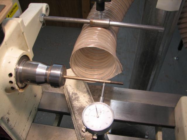

It might not be your mandrel. Do you realize how many pens have been made using a mandrel before all this "mandrelless" stuff? Using a mandrel is perfectly acceptable and I still use one for some pens. Check your HS/TS alignment. And just because the tips of the centers line up doesn't mean everythings in line. Imagine if you have two pencils touching tip to tip. If you move the eraser end of one of them the tips will still line up but you will be "out of alignment". Also, if the ends of the blank are not square with the TUBE it can cause some trouble. Check the mandrel itself for straightness, I use this method.....
Don't be afraid to use a mandrel, it's a great tool that needs to be kept in your arsenal.:wink:
