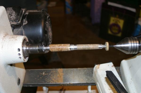

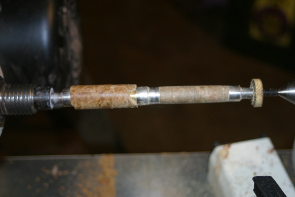

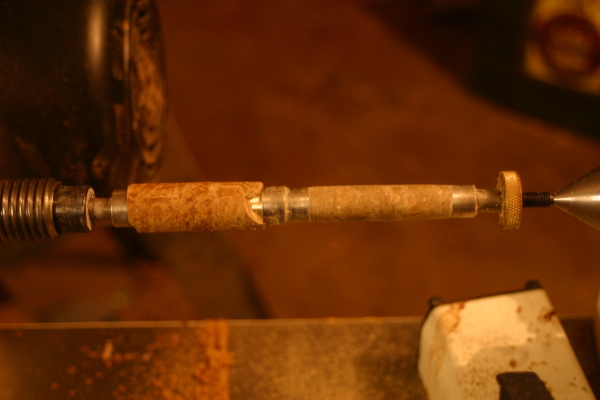

Preparing myself for the onslaught of "been there, done that" replies. I got a piece of gorgeous Teak Burl the other day and decided to turn this for a Jr Gent II for my office pen. As can be seen in the pics, I forgot to use the skew to knock off the corners. Here was my thought process:
/Man this looks good
/You know, I should probably grab the skew and
//SNAP
"Newman" (obscure Seinfeld reference)
Anyway, I almost cried as this piece of teak burl is absolutely gorgeous. I split the cap when I went a little too far with the gouge. So I have a question . . . is there anything that I can do with the "body" of this pen? Does it fit any other kits by itself (like a Sierra)?

Yep.. part it off square down to the brass. Drill out a piece of wood and glue in place. Re-turn just like you meant it to be there :)
Wait.. did I just admit to knowing how to fix an oops ;)
I have glue pieces back onto the blank. Then let it set for a while and then finish turning it. If there are any cracks I make a slurry out of CA and dust from sanding and fill it then finish and this would be a pen I would do a CA finish on.
I'd go for trying to repair it. Do you have anything left over from the blank? It's possible to do an inlay or onlay that might be almost imperceptible do to the figure.
Marc
I am with Marc try to repair it if you can find everything. I had a piece of bog wood burl blow up on me. I CA it all back together an ended up with a nice looking pen. Best of luck!
Travis
I went back out to the shop to look for the piece. Unfortunately, I still hadn't finished cleaning up from turning a piece of green mahogany this weekend (14 incher). It's like looking for a needle in a pile of needles. I'll try again tomorrow. If no luck, I'll do my first ebony band.
