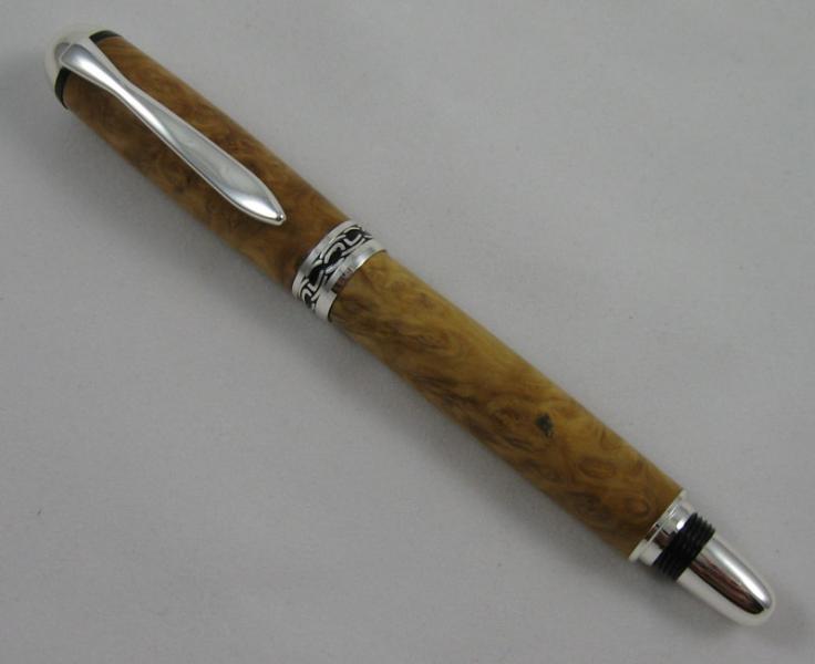

I'm not happy with the results from my Powershot A580. Attached is a sample straight from the camera, taken in my light tent, just resized and compressed to fit forum requirements. The image seems muddy and depth of field on a long shot is quite narrow. Admittedly shooting with the Auto setting, but aperture sets itself to 2.6 or 4 usually (no aperture priority), 80 ISO and around 1/100 second.
So back to the point of the post. Do you think f8 as a minimum aperture is sufficient for most pen photography, or is the bigger settings of f11- f22 going to give better shots? I know pushing the aperture that small could start creating noise by forcing longer exposures, which may be the opposite effect to what I want anyway. I'm just not sure.
With any lens, you are not at full sharpness full-open. As you stop down, you get sharper and sharper, until you hit f/8. After that, the more you stop down, you lose more sharpness due to diffraction.
The only reason you should stop down any more than f/8 is for depth-of-field, and only then, only stop down as much as you *need* to.
Also, if you're not using strobes, a smalle aperture means either higher ISO (and hence, more noise), or a longer shutter speed, which will be more blurry.
Also, if you're filling the frame with your pen, movement will be a very large factor, and the "1/focal length" rule won't even be in the ballpark for the shutter speed that you need, unless you have a rock-solid tripod and either a timer or remote.
The physically small sensor in a point-and-shoot imposes great limitations, but you can still improve upon what you're currently getting by throwing enough light at the subject to get your aperture around f/8, and your shutter speeds to at least 1/200th.

So Art, you're saying higher than f8 is not that great anyway? DoF is my concern, but I guess I can just align my pens better so they're pretty much in a plane for the picture. With my A580, I tried forcing the F-stop down with more light, but the stupid thing just decided it'd take f2.6 and a faster speed.
Above f/8, your sharpness will begin to degrade. Now, if you can't get your entire subject in focus, that doesn't work, either! So, if you need to stop down to more than f/8, then do so only just enough to get your subject in focus, and *that* will be your optimal balance between resolving power and actually being in focus.

As a rule, depth of field provides most of the visible sharpness cues. The type of distortion caused by stopping down a lens has little effect on perceived sharpness. Especially when the image is going to be displayed on digital media like a monitor screen.
If you want sharp, close pictures of your pens you will need to stop down. I usually use my 60mm Macro at f22 if I'm concerned about depth of field - which I am for pens. Another important source of sharpness is camera steadiness - don't handhhold close-up shots. Even if you're using a flash with high speed synchronization. Which brings up the third source of perceived sharpness - contrast. Avoid 'flat' lighting.

I've said it before and I will say it again, you do not need a DSLR to take good pen photos. You might need a DSLR and professional glass(meaning quite expensive) if your plan is to take photos for publication in a high end catalog, but even that could be debated. If your basic need is taking photos to put on the internet, a DSLR is definitely not needed. There are many, literally dozens, of P&S cameras that will do the job very nicely. Most of the photos you see posted here are not taken with a DSLR. The most expensive camera and lens on the market will not produce good pen photos if your lighting is inadequate, you either don't use a tripod or use a worthless flimsy one, or don't understand exposure and white balance. I have seen some truly awful photos taken with Nikon D3 cameras by people who just have lots of money to burn and I've seen outstanding photos taken Nikon D40 cameras by people who understand the camera dn pay attention to the basics. The photo you posted is probably 1 full stop under-exposed and that is easily corrected by setting the exposure compensation to +1.0 and using the histogram to verify the exposure.
There has been some dead wrong information put forth in this thread that needs to be corrected. First of all, for the majority of lenses image quality does not begin to degrade at f/8. The sweet spot for most lenses is in the range of f/8-f/16, but to make a blanket statement that all lenses degrade beyond f/8 is absurd. I have several lenses that I routinely use at f/16 and they are tack sharp. Above f/16, IQ does begin to degrade, even on the best lenses I own. There is variation and some lenses will hold IQ better than others at very small apertures but the image will not be as sharp at f/22 as it was at f/16 or f/11.
As long as you have the pen set up basically parallel to the sensor as in the photo you posted, the depth of field only needs to be about 3/4-1". I routine use a 55mm Micro-Nikkor lens set at f/11 for pen photos and never have a problem with DOF. I have a copy of Helicon Focus, used it once for a pen photo and haven't used it for that since. It is more trouble than its worth if your technique is any good at all and you just pay attention. I rarely even use it for serious macro photography and the best macro photographers I know don't use it. Probably the biggest waste of $30 I've encountered in photography.
There is a difference in DOF at a given aperture between P&S and DSLR cameras. That is why most P&S cameras have very small aperture ranges yet deliver excellent DOF. I can't remember the technical explanation for this and can't find the article right now, but I will keep looking and provide a link when I do.
If you're not using a rock solid tripod to photograph your pens, you are doing it wrong, period. At the distances involved in macro photography, the image will invariably be blurry no matter what the shutter speed due to movement on your part. Using some flimsy tripod is unlikely to resolve the issue and using a flimsy tripod with an extended center column will probably make it worse. I use a tripod that weighs about 5 pounds with a ball head that weighs about 2 pounds. There is no center column because I cut it down to almost nothing.
You stated that you need to photograph pens in RAW. Why do you think you need to do this? If you were shooting for publication in print that would be true because you need to get to a TIF format image, but for just posting to the web, large fine JPG is more than adequate. Someone stated something about shooting JPG and then saving it in RAW. That is really cockeyed. If you truly need the raw sensor data, you must shoot in RAW in the first place. You cannot retrieve that lost sensor data from a JPG, ever.

Absurd? Nope, it's physics. Do some reading. Or, look at actual resolving tests of lenses. Some will fall a little on either side, but f/8 is where it's at. Why do you think they've been saying "f/8 and be there" for so long?
Here are some actual tests (chosen at random), and you'll see that the peaks are centered right around f/8:
http://www.photodo.com/topic_52.html
http://www.photodo.com/topic_132.html
http://www.photodo.com/topic_14.html
You'll see that max sharpness is within 1 stop of f/8. You'll also see that while some lenses are as sharp (or nearly as sharp) a little wider, but that when stopped down more, sharpness degrades quickly enough that it's often just as bad at f/16 as when they're wide-open. The sweet spot (in terms of resolution) is actually more along the lines of f/5.6 to f/8.
I could post more tests, but I've never seen one depart significantly from that pattern. Be careful slinging around words like "absurd"...

OK, so if we're saying a P&S camera is sufficient, how does one tell a sufficiently accurate model, apart from seeing pen pictures taken with evert type?
The problems I see with the A580, visible in 100% views of the original out of camera Jpeg are as follows :-
1. Picture is always under exposed. My light tent has two 5500K 24w energy efficient lamps. There seems to be plenty of light. Are the highlights on the pen fooling the proce3ssor into underexposing? I almost alwasy push the exposure .5 - 1 ev in photoshop to try and correct it, which is easy, but shouldn't be needed. Flooding the light tent with more light simpkly produces washed out highlights, not a better image. I put this down to lens or ccd quality.
2. The image is usually "muddy". There seems to be a lot of blurred detail when looking at the wood grain. I do use a tripod normally, but it doesn't seem to help. Evedn images taken outside in bright daylight at 1/160' or more seem to have this problem. Not sure if this is a lens, ccd, processor or jpeg conversion problem.
3. Jaggies & noise. Seems more than ther should be to me. I put this to jpeg conversion.
4. DOF is limited. We've discussed this and ways to get around it, so ignore that for now.
5. Dynamic range. Seems limited - highlights are wshed out, shadow detail is low. Apart from HDR tricks in photoshop, I know it's a limitation of compact cameras, but can be better on better quality units.
6. Colour reproduction. While saying the images are underexposed, the overall colours always seem washed out. Blacks are kind of grey, greens are always pale, a glorious blue sky looks smoggy. No idea why.
My whole goal is to get images up on my pen shop web site that jump off the page and grab the viewers attention. I want them to stand out, show the detail of the handmade finish and look like they are worth more than a corner store Bic.
As secondary concerns, I make & sell boomerangs over the net which need decent photo's but not the quality of the pen shots, I also enjoy taking pictures of sunsets, misty morning fog, close ups of insects, reptiles, flowers and other small objects, The moon & stars, and my family. Printing I do very little of, but the occassional A4 photo will come out.

The problems I see ... are as follows ...
3. Jaggies & noise.
6. Colour reproduction. ...the overall colours always seem washed out. Blacks are kind of grey, greens are always pale, a glorious blue sky looks smoggy.
Most of these problems could be caused by improper exposure and incorrect white balance. Most current digital cameras beyond the point-and-shoot variety will give you sufficient control of both.

Precisely! Back when I was taking photography classes, I had an instructor who liked to say that what's behind the camera is much more important than what's inside it. From your previous posts, I believe you have an understanding of the fundamentals, so all you really need is a camera that has sufficient controls to let you experiment and find what works.
