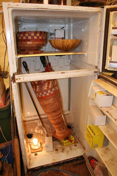

More on a Refrigerator Kiln

I use a 100w bulb and have it wired to a ceiling fan speed control switch. This gives me more control over the temps and can get it up to near 125-130 degrees. The freezer section is set up to maintain around 70 degrees and I store my casting resins and additives among other things I want to keep warm as my basement can be a little on the cool side (around 60-63) in the winter months.
Greg, do you have a separate bulb and fan in the freezer section?
Yes sir! I use small computer case fans both in the hot box area and in the "warmer". These are also connected to a ceiling fan speed control switch.
