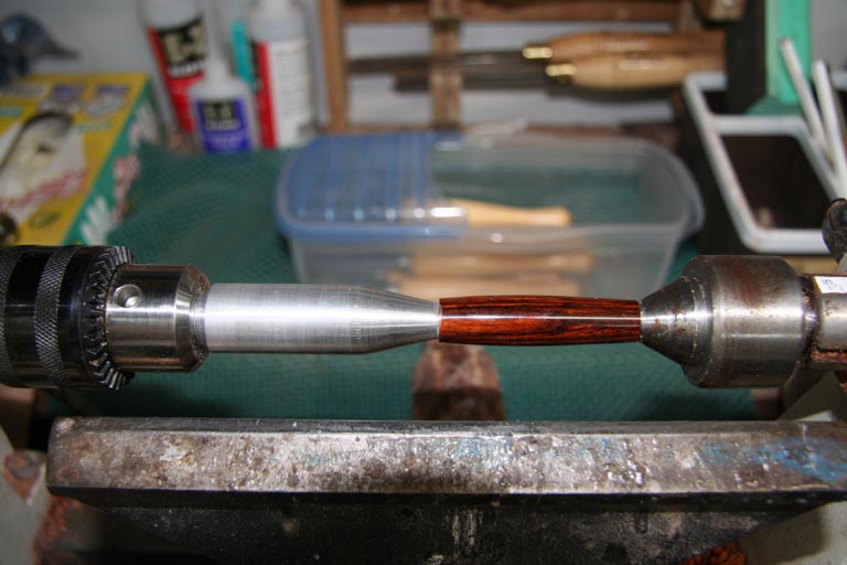

I didn't see written above - exactly what I do.
The bushings don't wear down for me because:
1. I do not sand with the bushings on;
2. I do not turn the blank down to the bushing size. I turn the blank down to about .02 proud, and take the bushings off for sanding and sizing. (I check size by calipers)
Below is the picture of the blank mounted without bushings. I can take the blank and bushings off of the lathe, remove the bushings and put the blank back on the late in about 10 to 15 seconds without even thinking about it.

Hank -- I've been trying to learn to use your method and I have encountered a problem. When I have the blank set up as in your picture either (1) the blank is not "snug" enough and it doesn't rotate freely, or (2) it is "snug" enough and the pressure flares the ends of my tubes. How do you deal with that?
JimB
Mar 18, 2008
4,682
West Henrietta, NY, USA.
Keith - I've done what Hank shows on my last 10 pens for sanding and CA/BLO finishing. I haven't flared any tubes. It is a delicate tightening process. I place the blank against the headstock. I then slide the tailstock against the blank and lock it in place. I then give the hand wheel just a small, small turn. Probably the equivelent of moving it from 1:00 O'clock to 1:30. Lock it in place. About half the time when I start sanding it is still a bit loose. A very, very very small turn takes care of it. It takes a little trial and error.
I like Hanks method a LOT. My sanding is much much better now that I don't need to worry about sanding dust from the bushings. My CA/BLO finish is also much easier to apply and I never need to worry about bushings getting glued to the blank. It's worth the effort to learn Hank's method.

Keith,
I probably use the strangest method of anyone on here - I listen to the sound. Way way back when, we used to tune engines by the sound! Really!. The sound of something running tells me a lot and I don't know how to explain it.
AS to the lathe, I pull up the tail stock, tighten it by feel, turn the lathe on and then tighten with the back wheel until I recognize the sound. "Too tight" has its own sound. "Too loose" does too, and so does "just right". I don't have good ears for perfect matching of pitch, but I can tell when something is not right mechanically.
There is only about 1/4 to 1/8 of a turn between just right and too tight. That is plenty of space for adjustment. In my opinion, it is worse to to have it too loose - and then apply too much pressure in sanding/rubbing, which cause a differential of speed between the tube and dead drive.
From this - Flaring _will_ be caused by being a smidgen too loose. The fast turning dead drive will spin and wear/flare the tube as it slips. Metal fabrication is often done with this method. Differential speeds between two metals will cause deformity quick and flaring is a controlled deformity. It can be done by pressure alone but it is easier with differential speeds. Don't just assume that your flaring is because it is too tight. It would be my guess that the slippage is what is causing most of the flaring that you are getting.
