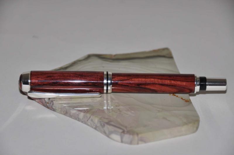

Anyway, here's a pen made from some of rarestwoods rarer woods. Unretouched, single point flash, no polarization. As you will notice you can see right down to the chatoyance in the lower barrel even under what are terrible lighting conditions. Nothing incredible, and a lousy photograph, but it demonstrates that my method does work. All methods work, since we are really doing exactly the same thing despite the complications each of us performs. I'm a minimalist. To me each added step variation is a chance to make an expensive mistake.
