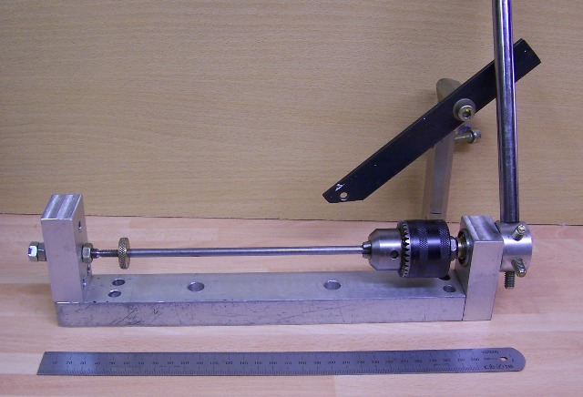

I've been messing around for ages with old gears and cogs to make another pen mill that can be used on my metal lathe and cut metal as well. I only wanted a hexagon shape with a slight twist - about 60deg.
I couldn't get the ratio high enough with the bits and bobs I had and eventually came up with this idea.
It is nothing more than an indexable jacobs chuck. The long chrome arm slides up ( or down ) the ramp, turning the mandrel while the cross slide of the lathe is moved.
The aluminium collar with the threaded studs is changeable for different designs ( pentagon, octogon etc )
I didn't realise it at the time but with the ramp parralel to the mandrel, the rotation of the blank is not linear. No biggie as I can spin at an angle till I get it correct.
The aluminium is from an office wall partition.
I've only tried it on this piece of red PR so far. On the weekend I'll try ali, then some stainless. I'm pretty pleased with the result and it was real easy to make:biggrin:

nice work. It does not appear that there woudl be a problem with the rotation as it is. except maybe roughness in the ramp or something. I guess that is why it is called learning. any more info as to just why the twist is not linear?
The twist is not linear probably because the distance between the centerline of the mandrel and the ramp changes as the arm goes down the ramp. Mark the arm in the starting position and compare the mark at the end of the cut.
Bob
Daniel, geometry is not my cup of tea, and I could not explain it correctly. But the big chrome arm rotates from approx 1 o'clock to just past 3 o'clock positions. When the arm is travelling near the top of the ramp it rotates less than it does when at the bottom of the ramp.
Look at the far end of the blank, it is almost straight.
My theory is that if I move the top of the ramp away to the right hand side but keep the bottom where it is, then it will work.
Essentially I want the same point on the arm to be in contact with the ramp all the time. Clear as mud??:biggrin:
Just checked and I was wrong:redface: ( Nothing new there!!!! )
The top of the ramp needs to be closer to the left. ( as in these pics )Although still not perfectly linear, at least the start and finish points are in the same place. I think that to make it spot on, then the ramp would have to be curved ( to the left at the bottom ) but I think it will be close enough for me.:wink:

Hi Randy, LOL, I knew I could rely on you to ask difficult questions.:biggrin:
The ramp is fixed and does not move. As the mill is moved across the lathe bed by the cross slide, the weight of the arm rotates the mandrel as it (the arm ) slides down the ramp. That is the reason for the big heavy arm.
I was going to use a lighter, shorter one assisted by a spring.
In the first three pics, the ramp is parralel to the mandrel / mill.
In the second two, I have adjusted the position of the ramp but not the angle. With the ramp turned to this angle, the mark on the arm is resting on the ramp by the same radius from the mandrel whether it is at the top or bottom of the ramp. Half way down the ramp, the mark is off somewhat. This is why I figured that if the ramp was curved then it would be spot on.
But hey, if I wanted perfection I'd buy a machine to do it for me:biggrin:
Below is another pic of the thing on it's own.
PS, pwhay, thats a cool machine you have there. Have you rigged it to doo spirals yet?:smile:
I got it! To make the thing rotate the same all the way thru you just need a curved slide! The distance from where the 'arm' touches the slide at the top and bottom of the stroke is longer than the distance at the middle of the stroke. Clear as mud? So, just calculate the radius needed, and walaa!:cool:
