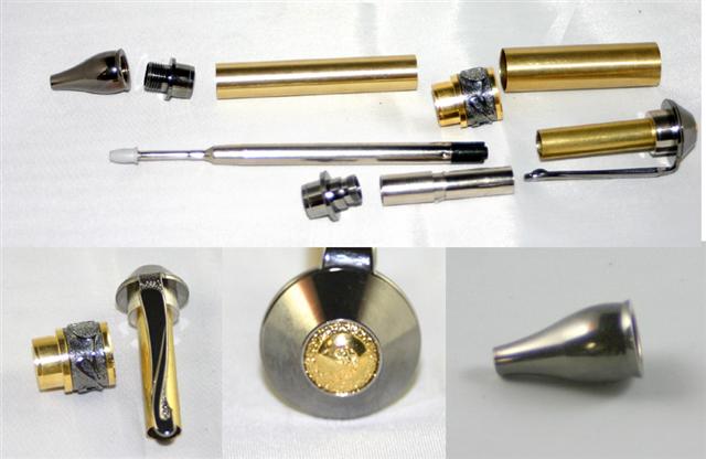

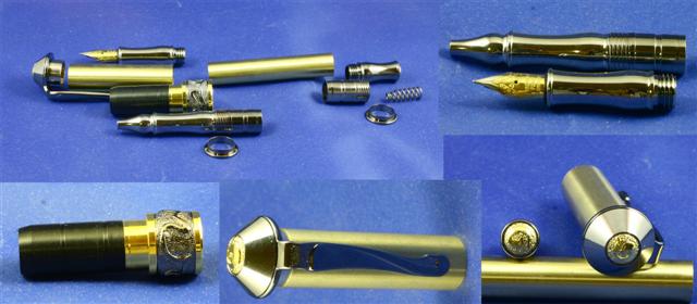

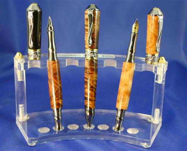

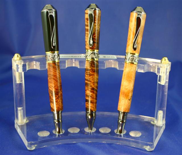

Pictures from left to right: ball point parts, rollerball/fountain pen parts, pens open, pens closed
Pen materials from left to right: RB cap is black acrylic and the barrell is Hon. rosewood burl; the ballpoint is stabilized curly koa, the fountain pen is maidou burl

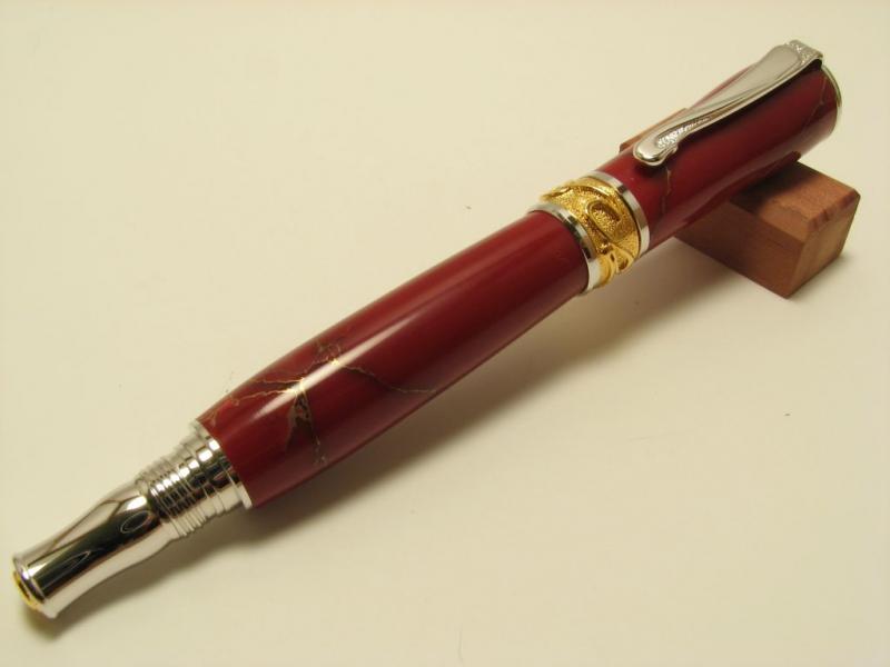

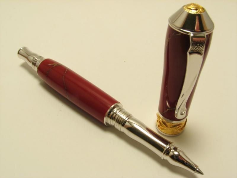

The Nouvoue Sceptre is the nicest pen kit I have used, it isjust a solid, good weight,classy pen followed by the Majestic Jr. imo
