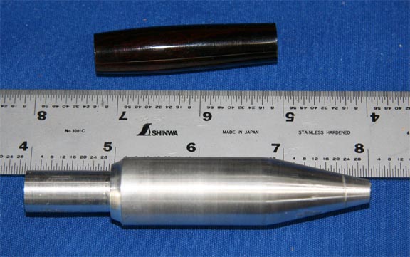

Instead of using a mandrel, you will need a dead center ( or sometimes referred to as a drive center). Below is one I turned out of Aluminum but you can buy one from Grizzly in an MT 2 size here.
I made my dead center on my lathe:

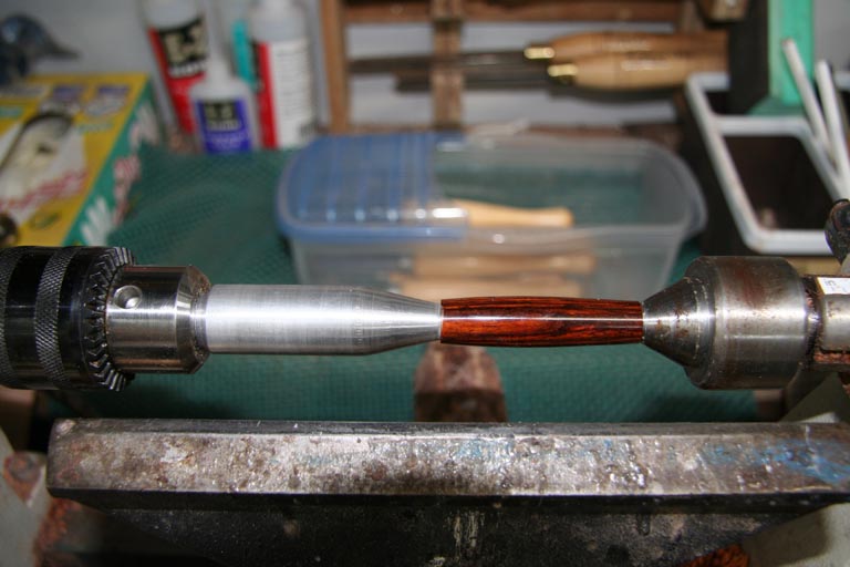

Here is a pict of it on the lathe. I turned the blank down to rough size with the bushings, but removed the bushings for sanding and finishing. No sanding dust, no shrinking bushings due to aggressive sanding, no glued bushings to the blank, reduced risk of out of round from mandrel problems.
It is MUCH more simple to use than to describe. And if you are already using calipers, you are 1/3 there.
