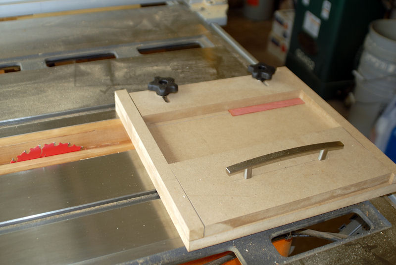

I've been using a lot of wood veneers in my segmenting lately. Initially I was cutting the veneers with a utility knife and ruler. I decieded I needed something more accurate and efficient. When I think accurate and efficient, I often think of my table saw. :biggrin:

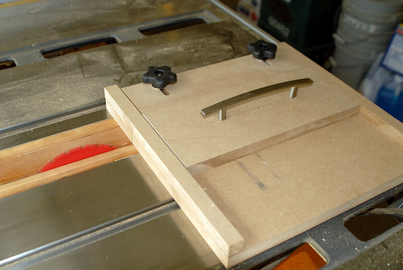

The following pictures show what I came up with. The jig has a runner which fits in the miter slot. A couple of points when building the jig:
  • Assemble the base, leading and trailing edges first. When attaching the leading and trailing edges don't use any metal attachments (brad nails or screws) in the area where the blade cut will be.
  • Attach the runner. Make sure the runner fits snugly in the miter slot with no play.
  • Raise the blade 1". I used 3/4" MDF so this meant the blade would be 1/4" higher than the bed of the jig.

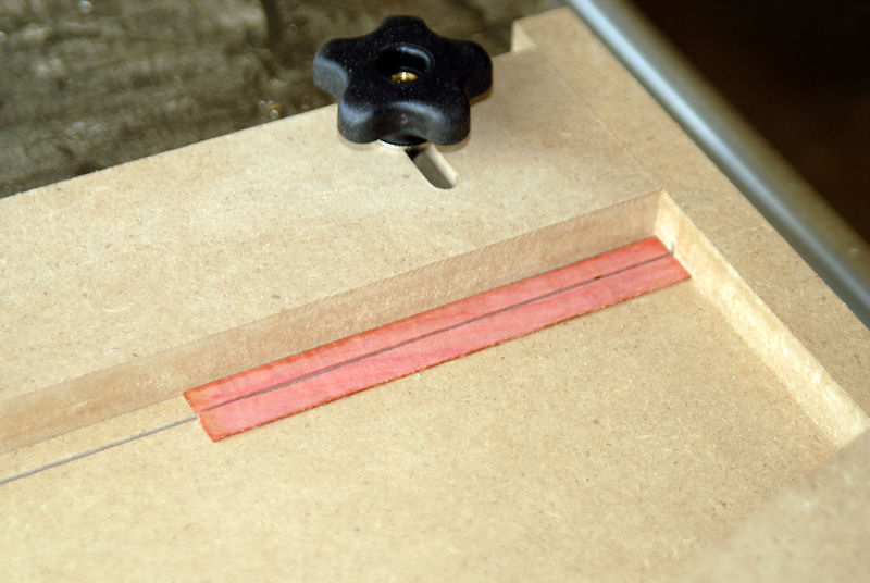

  • Run the bed through the saw. You now have a cut line in the bed of the base which is perfectly parallel to the miter slot without any measuring :)
  • Add the jig fence and hold down block with a handle. Make sure the screws attaching the handle of the hold down jig are well offset to the cut line! The bed of my jig will accept a piece of veneer just over 12" long. I made the fence so that I could rip/crosscut a piece of veneer up to 2"
  • A good coat of wax on the base of the jig and runner will help it to glide smoothly.
Because the cut in the base is now a zero clearance kerf and you are supporting the top of the workpiece with the hold down block, I'm able to cut the veneer with no tear out at all.

Nick, the veneer is held down with the hold down block. If you look in the second picture, you can see the cut is in progress, the blade is turning. The veneer is hidden below the hold down block that has the silver handle on it.
The blade is a Freud Diablo 7 1/4" circular saw blade. Kerf width of 1/16"

Chip, I use a paper cutter as well for some cuts. It works well and you are correct has less waste. However I find with the longer cuts I am able to get a more consistent width using the TS jig.
Good eye on the Ridgid. The insert is just friction fit. I did not use anything on the lip. I've read that this can cause a problem with the insert lifting up during the cut, but I have not had any issues with it at all. If you look closely at the insert you will see two cuts in it. One is for the Freud 1/16" circular saw blade. The other is for my Woodworker II blade. I just flip the insert around depending on which blade I have mounted on the saw.

I made my sled from 1/2" MDF instead of 3/4". My Delta saw doesn't allow the Diablo 7 1/4" blade to stick up above the table much. I find that the 1/2" MDF is just as stable as the 3/4" for my needs and I get the extra 1/4" capacity for my segment slices.
I like the way you used the "lid" to hold the material in place, I just hold mine with a narrow push stick. I think I might modify mine a little, thanks for the idea.

You're right George. 1/2" MDF or as Ron pointed out 1/4" ply is more that adequate for the bed of this jig. The main reason that I used 3/4" MDF for this jig is because that is what I had in my scrap bin at the time :)

Does this mean eventually you need to replace the block/handle section? As you must chop a section off each time you pass the sled through?
Good job on the sled though, very professional looking!
Yes, the hold down block is sacrificial. Eventually it will need to be replaced.
