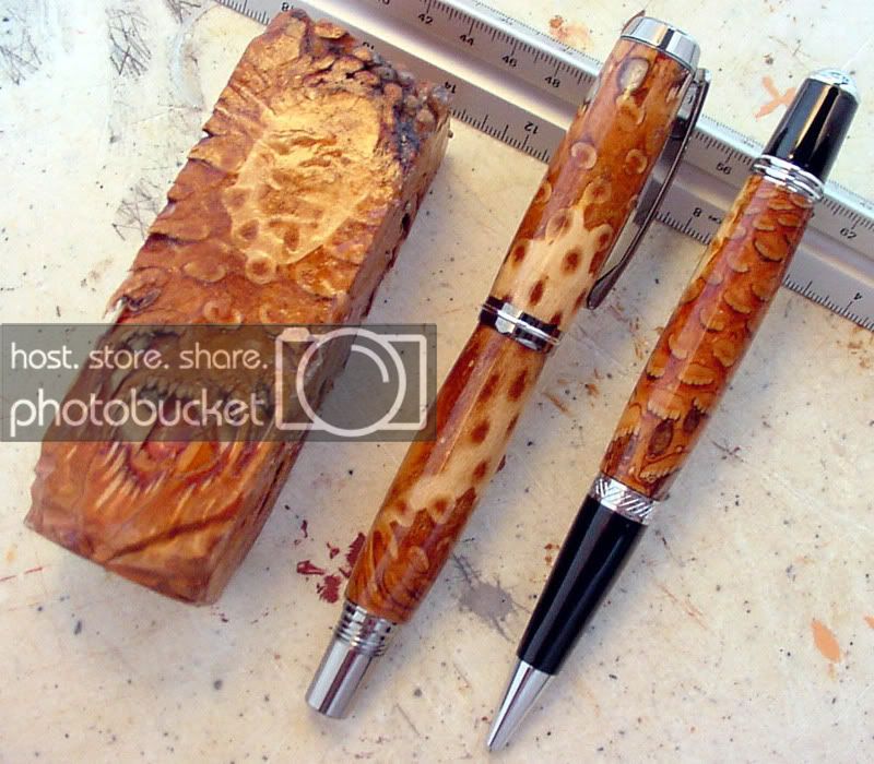

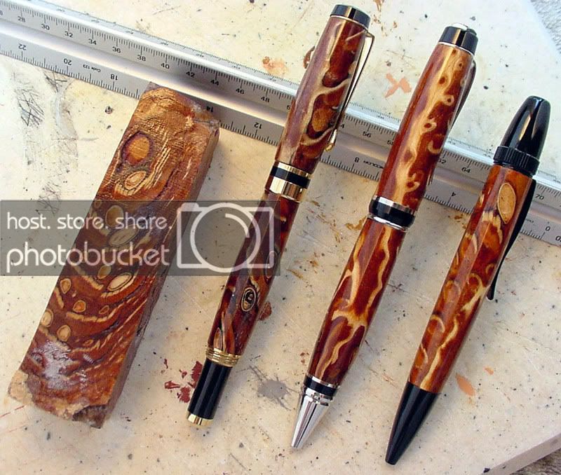

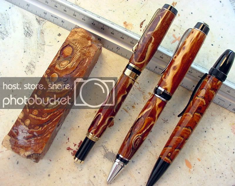

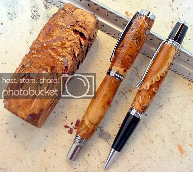

I don't post here very often, and I haven't been showing off my latest works... but over the past week I've made a variety of pine cone pens that I thought you all would enjoy. I have several sugar pine trees nearby which provide me with a fairly steady supply of large, closed cones which I pluck and set out to dry for a couple of months before working them over. 2 months ago, my wife and I went up to the northern California coast to do some camping and abalone diving when I came across an interesting tree... a Knobby Pine, which only grows along the coast. These trees had the most beautiful LARGE cones which dried closed on the branch. I plucked half a dozen and turned 2 pens from them. Here are some of the results with a blank shown for reference: (I apologize for the large pictures)
Sugar Pine cones are dark, very seedy, and are very hard requiring at least one re-sharpening per session.
Knobby Pine cones are lighter in color, much softer, and less seedy. When I make a pen with a cap, the pine cone has to be at least 8" long in order to have enough material to make both parts. otherwise, they lend themselves quite readily to single-piece pens such as the Wall Street and Patriot styles.

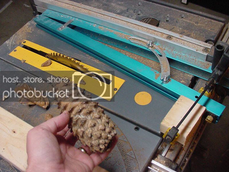

Could we see some pictures of the cones before being cut up? This cone must be huge compared to the ones I am finding.
Hi Wrangler
The cones are generally 6" long, but I look for the 8" variety because the taper of the tip looses about 3" of useable material. It is a rare event that I am able to get two pieces from the same cone.
Here's a picture of a Sugar Pine cone that I was able to get two pieces from:
Since most cones are asymmetrical, I use a taper jig on the table saw to get the cut down the thickest part. This cone had the bottom cut off and the inside filled with thin CA prior to cutting square.
