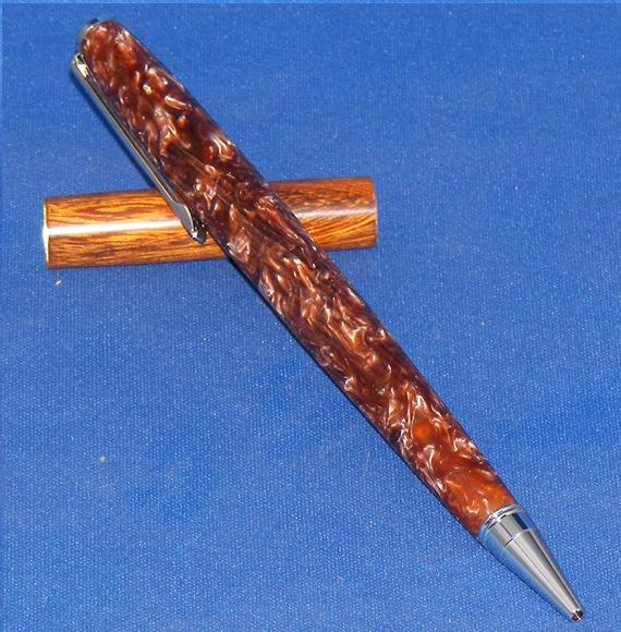

Was just messing around on the Turncrafter since I'm still waiting for a new headstock on the Grizzly. I knew it would be slightly out of round, but just wanted to turn something. So I decided to turn an acrylic blank that I got in a trade. While I was turning I got a good bit of vibration when I was working on the center of the blank, which this one is extra long for a slimline. Also broke in Johnny's slimline blanks that I order a month or so ago (great job as always).
I did do one thing different on this one. Since I knew the nib would be out of round due to my lathe, I put the beaded centerband for the kit down next to the nib. It makes the roundness a little less obvious and adds a little something extra to the kit.

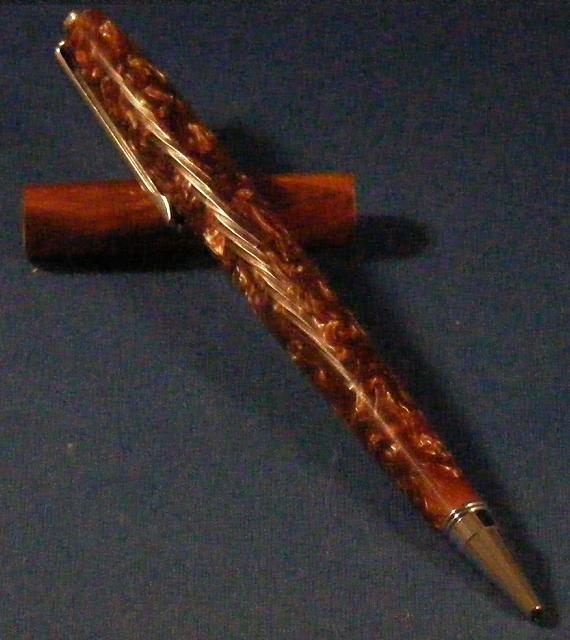

The surprise shows up better in this pic with different lighting. I got a chatter spiral. Very cool. Wish I could say that I planned it and could do it whenever I wanted. I'll have to play with a couple techniques I've read that may give more consistent results.

Wow, that is really cool! I've been reading about chatter tools. It's amazing you got that effect with just a wonky lathe!

Karl, Oh the lathe didn't directly cause the chatter. The cast Iron bed on my PSI lathe has a crack in it that opens slightly when pressure is applied from the tailstock. That causes the out of roundness I'm experiencing.
The chatter was likely due to several things. The one piece blank that was nearly 6 inches long. The fact that only 2.5 inches of the blank had a tube in it. and the light tailstock pressure from the lathe.
