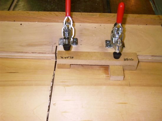

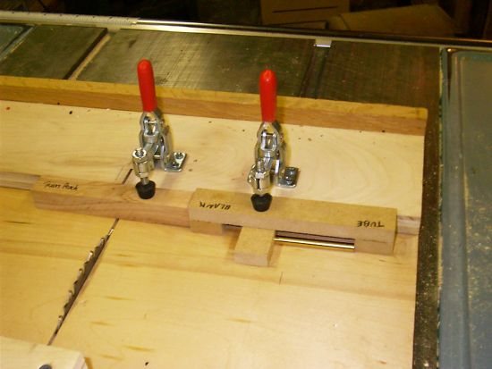

After turning 20 pens for one job
I said to myself "self there has to
be a better way than marking then cutting
the blanks for 20 of the same type kit"
I use a table saw and had an old panel cutting
thing that I don't use any more so this is
what I came up with.
I think you can see it is very easy to build.
I made the thing (tech term) that I put the tube
in to offset the blank 1/16 shorter to allow for
gluing in the tube.
I hope you understand cause I don't splain thangs well:D
steve
jhs494
Jan 3, 2006
566
Ohio, USA.
Nice idea Steve. It took me a minute to see what you are doing. It looks like you have solved your problem.
I like it that you are using the tube to set the length.
No reason for error that way.
Good Job!

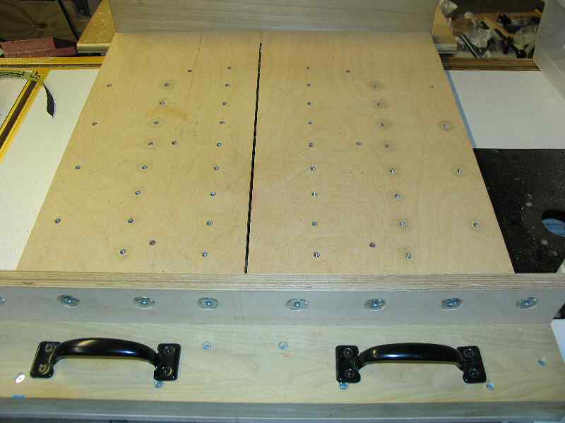

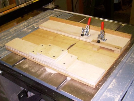

Steve; The photo says it all. I had made a similar thing, but I think your setup is easier to build and use!
Can I make a copy?
I will have to add another jig to my table saw sled shown below. I always over build things! [^]
