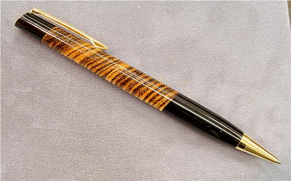

This is the Jay (Pickens)-Line pen with the “twist tip†transmission. It is one solid piece. The plastic/wood joints and the finial are all cut at 15°, even though they don’t look like it in the picture.
This pen is ½†longer than the kit.
The blank was turned round and straight to 5/8†diameter between centers so it could be held in a Bealle collet chuck for drilling from both ends. The little center marks are used to make sure it is running true before drilling. A new or newly sharpen drill will prevent drill wander. The through hole has to be absolutely straight and concentric.
The drilling could be done in a scroll chuck, but they aren't as accurate as the collet chuck and there is more chance for error. The collet chuck is a good investment for anyone making this type of pen.
I used a "J" drill for the upper 7mm tube and a 19/64" for the larger lower tube.
The tubes were glued in with CA from both ends and I used a mandrel rod to make sure they were lined up with each other. This is necessary because the transmission has to go into the upper tube when the guts are pushed in from the tip. All is not lost fo there is a little mis-alignment, but I would reject the pen if the mandrel couldn't fall through from its own weight when all of the tubes are in place.
The wood is Zebra, the pen is a Berea Stream-Line, and the finish is a shellac friction polish over a polished CA glue.
Thanks to Don Ward and Jay Pickens for the pen, and to Skiprat (whoever he is) for the idea of doing it with a "twist tip".

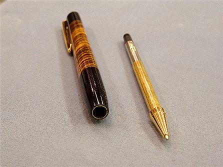

This is the business end of the pen. The tip is lined with a tube that I call the 7.5mm for want of any other name. It slips over the 7mm tube. I get these tubes from Woodcraft and they are sold as the Classic American tubes. There are 2 sets of tubes in the package and these are the smaller ones. They are a good fit into a 19/64†drilled hole.
The “assembly†is the entire lower barrel of the Slim-Line without the wood. I made sure the tip was secured by using a drop of the “Red Locktiteâ€. The blue is more available, and it works, but the red is permanent.
There are two things that need to be done with the transmission to make it easier to twist and make the "assembly" easier to remove for changing the refill. The first is to soak it in some Mineral Spirits (paint thinner) to get rid of the grease so it twists easier. Then a drop of kerosene or WD-49 will lubricate it. The other thing is to file down the 3 little ridges at the top of the transmission to make it an easier fit into the upper tube. This has to be done carefully because I want enough grip to twist the transmission, but not so much that the “assembly†is difficult to remove from the pen. If too much is removed the very end of the transmission can be crushed to make it slightly oval, but not so much that the refill won’t go in. This is enough to grip in the tube, and might be the better way to do it.

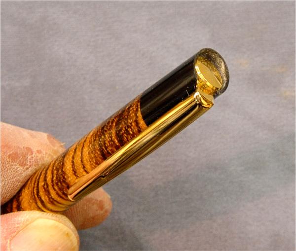

This is the top end of the pen. The Stream-Line clip and finial are recessed as described in the Jay Pickens article. The only difference is that it is recessed ¼†deep and the top is sanded back to the angle after the pen is finished.
The recess is made with an 11/32†drill and there is clearance for the Slim-Line bushings so the pen can be turned on the mandrel like a “normal†pen.
