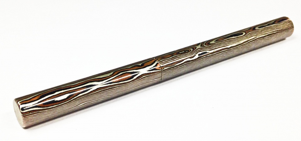

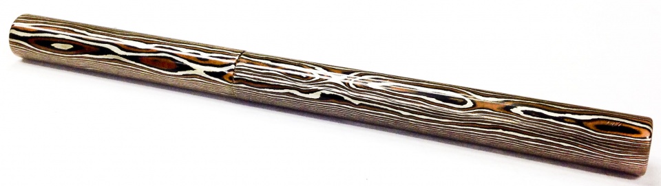

Finished this pen early this morning for a very special friend. It's made out of really beautiful mokume gane. The rod was made by master metalsmith Mike Sakmar by
fusing combinations of the three metals: brass, copper and nickel silver into a 12 inch long and 3/4 inch round billet. Patinated to bring out all three metals. Heavy...will be a desk pen.

Hey Doc,
You do not like to dwell inside "the box" for very long, do you? Great results, as you let your creative side run free. Really nice!

Amazing pen. What did you use to patina it? Now I have ideas for my Mokume that's sitting around.
Wow, that's pretty special.:eek: The metal colour combo is very striking.
Is the black the brass or the nickel silver?

I am sitting here looking at what you have created and am absolutely speechless. The lines of the pen, your attention to detail....and oh my yes, the amazing colors!!!
It is spectacular work of art. A true masterpiece.... And without a doubt one of the most beautiful pens I have seen!!!!

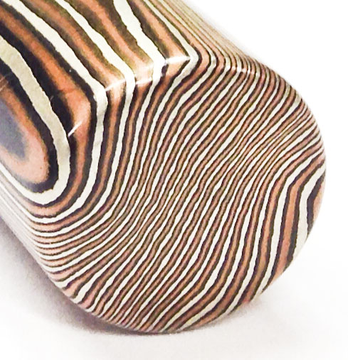

Ahhhh.....My grasshopper! You have turned into a butterfly! There is nothing left to teach. You have turned into an amazing pen maker Doc and i envy the person receiving this beautiful pen. The pen is beautiful and you did a great job keeping the grain matched from cap to barrel. The front section is a little off, but im sure that this was not the easiest of materials to work with. I hope to be able to use some demascus someday, just to rich for my blood right now. Heck i hope i even make a pen anytime soon. I almost have my shop set back up, so hopefully soon.

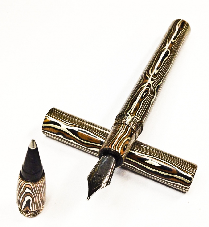

Finished the fountain pen section for the pen to add to rollerball. Sports a Ruthenium plated #6 steel JoWo nib and feed.

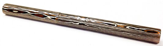

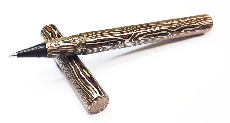

Since there have been questions regarding finishing of this Mokume pen, I thought I would answer, hopefully, some of them.
The pen after machining was sanding to 500 grit, followed by a treatment with a Paasche Air Eraser with Aluminum Oxide M-6 abrasive.
Due to heterogeneous nature of the Mokume, special care is taken when working with it as to not "smear" one layer of metal over another. Rinsing with a citrus detergent yielded an oil and residue free matte surface on the pen. The matte surface showed pattern better than a highly polished one. The latter treatment was followed by an "Baldwin No Name Patina Prep" which used feldspar and an acid treatment to clean and etch the surface. The pieces were then maintained under heated water to prevent exposure to the air. Patination is done immediately upon removal from water and changes the color of the metal, by selectively oxidizing and preferential darkening one of the component metals thus increasing contrast. Copper and copper alloys, when combined with precious metals, give the strongest possible contrast because of the ability to both etch and patina the copper. I used "Baldwin's Patina Solution" as it combined several steps. The final finish on this Mokume Gane pen demonstrated how a surface with little visible pattern transformed to a three color pattern which distinguished and sharply delineated all three metals in a very pleasing swirl that literally "popped". Patination of the pen involved multiple trial attempts on my part. I utilized differing immersion times in the solution to allow for three distinct colors to emerge on the single pen in the most pleasing hues and tones.
Finally, to prevent oxidation, seal the surface, protect from body oils and further enhance the appearance, 3 coats of Caswell VHT-Metal Lacquer were applied to the pen.
