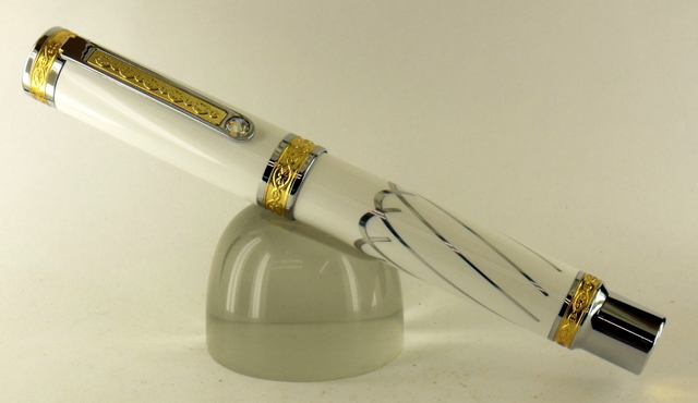

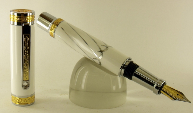

Here is todays effort ( I'm on leave :biggrin: )
A blingy Pristina with 'linking' aluminium feathers.
These Pristina pens may be a little over the top, but they are perfect for this type of blank as they have so much meat on them.
The design didn't quite end up where I would have prefered, but overall, I think it's ok.
I knew the pattern would 'shrink' as I turned it down, but thought it would actually shrink more from the back end than it did.
I hope you like it too:biggrin:

Very beautiful! You keep raising and raising the bar which is awesome. Your designs are over the top!
mtgrizzly52
<img id="ums_img_tooltip" class="UMSRatingIcon">
Stunning is the word!!!
That's just so beautful,Wow! I just love to see your creations,and it's fun to try to guess how you did it.
Steve
That is a gorgeous pen and lovely work. Isn't it an Empress rather than Pristina?

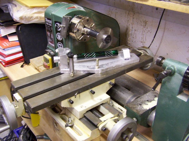

hate to ask but how would you cut the blank to inlay the aluminum to make the curve at the end. I can not visualize it.
don't mean to steal your idea, but I would like to understand.

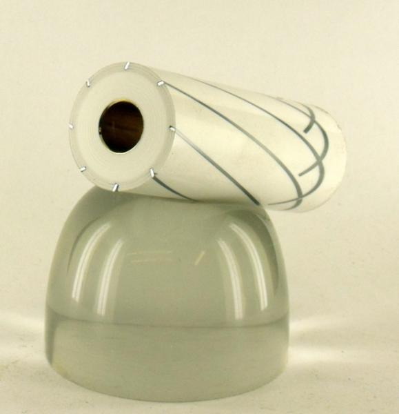

As always a very fine piece of art. Well done. A couple questions, would you know if that is the same kit as Timberbits Spring Blossom??? With the Spring Blossom the bottom barrel is very very meaty but the upper barrel is very thin. I could not even do a braided copper mesh on it.
Also, what are we looking at with the last photo showing the cross section??? I see 2 different colored materials. The outer one is darker up to the segmenting of the aluminum and then gets lighter.
What thickness of aluminum did you use for the segs???
Thanks and thanks for showing.

The cut isn't that difficult really. Please look at the set up pic.
1. The slit saw is set to 45 deg
2. The Rotary table ( which holds and indexes the blank ) is set around 60 deg.
3. The Compound table is then used to pass the the blank through/under the blade.
4. A suitable thickness metal piece is then glued in the slot and the rotary table rotated 45 deg ( 8 feathers ) for the next one.
It has that curl on the end because the blade starts deeper than the mid point on the blank.
The other end is only thin because that end of the blank is further to the left of the cutting edge of the blade. ie; shallower cut. Sorry if that doesn't seem to make sense. :redface:
John, the different colours on the end of the trimmed blank are simply the aluminium / uncured CA. :wink:

I did not understand much, anyway thanks for the explanation, I understand, however, that certain things need to make a special equipment, not a simple lathe.

Massimo, it is sad to see someone just give up when they see a tool they don't have or an obstical they don't understand.
Each individual pen is the END of a journey and the fun stops when the pen is finished.
Yes, a milling machine certainly helps. As does a metal lathe and lots of other tools too, but these simply allow us to explore newer ideas.
The vast majority of the stuff I show and lots of what others show can be done with BASIC tools and a little bit of creativity.
Here is a pic of a little indexing fixture I made a few years ago with a hacksaw, a file and (probably a hammer:biggrin: ) It can do exactly the same design to a blank as on this new pen.
The pic shows my cheap 'pipe' wood lathe and a cheap compound table over the bed with the jig on top. :wink:
Browse through the Tools, Jigs etc Forum and you will see many wonderful gadgets that have been used by many people to make extraordinary pens. :biggrin:

John,
The CA glue in the bottom of the cut has no air and therefore takes longer to cure / set / dry than the glue near the surface. That's my theory anyway as I've previously cut segmented blanks very soon after they been made only to see wet glue smears on the cut. The grey line is aluminium and CA.
Ok, the pen kit is a mystery, but possibly my error. :confused: It came from the empty bag in the middle. The bag says Pristina but is not the same as the still bagged Pristina on the right. It is the same as the un-named kit on the left which I think could be an Empress.
The blade is 3 inch x 0.018 x 1 x 230T. The aluminium is 0.016 but fits nicely in the kerf. I found that using a thinner blade runs the risk of the inlay sticking before it's fully inserted. Like a tube getting stuck half way in the hole !! :mad: ( I've only heard of this......never actually happened to me !!:rolleyes: )

John, I'm reasonably sure this is an Empress as it has the bling stone in the clip. The Spring Blossom doesn't. The tubes are different on the Roman Harvest.
Body ; Tube 8.53mm Finish 15.26mm ( Lots of material )
Cap ; Tube 15.54mm Finish 16.66mm ( Thinnish )
