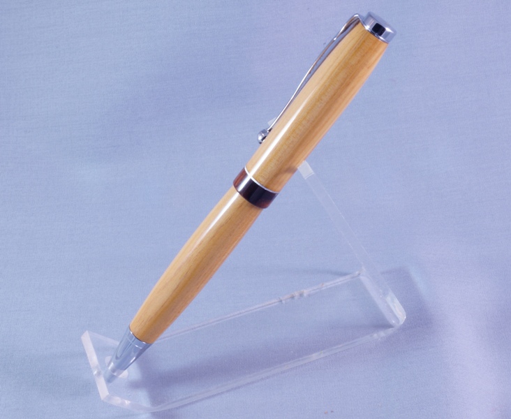

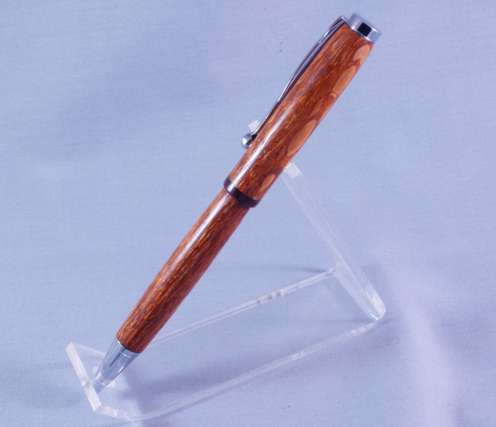

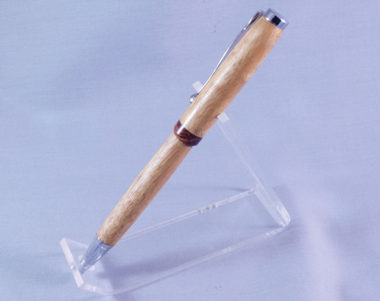

Ok, I finished the pen. I did run into a small mishap. When I was buffing, I guess I got it too hot, and the paper towel stuck to the blank. I had to go back to 600 to get off all the pieces of paper towel. I guess the shellac caught it just at the right time. But other than that, no issues at all.
Below are 3 pens I'm making for "Pens for the Troops". I did nothing to the photos other than to crop & resize. All the pens were wiped with a soft cloth before being photographed. About the only thing different was the 1st pen had a more open grain, and was more red. Looking at the cocobolo CBs in all 3 pics. They look similar to me as far as shine. Other than that, I do think Mike's method is a big improvement as far as getting a higher gloss finish than the way I used the finish initially.
Thanks Mike!!
The 1st is Mike's method.
attachment.php
Next is CA.
attachment.php
Finally is just Pens Plus without the walnut oil sanding. I basically used 3 or 4 coats like the video from the website showed.
