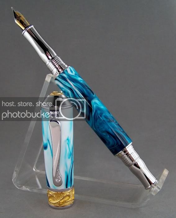

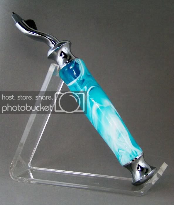

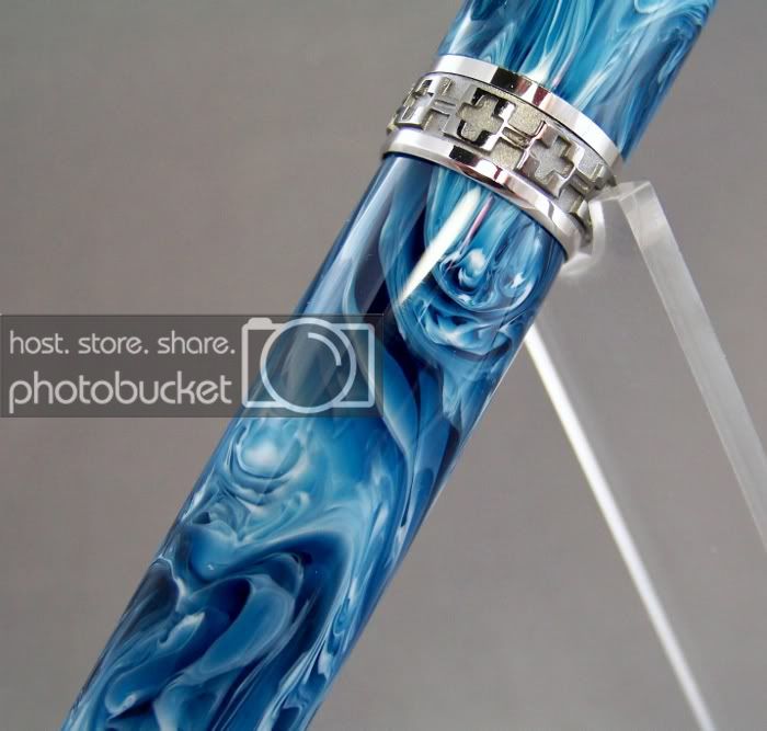

Here are some examples of paint choices and their effects.
Same exact blank:
Reverse painted with a light skyish blue (to match the color of the raw blank)
Reverse painted with a dark midnight blue
Another set of identical blanks:
Reverse painted with a medium blue (to match the blanks raw color)
Reverse painted with a darker navy blue
