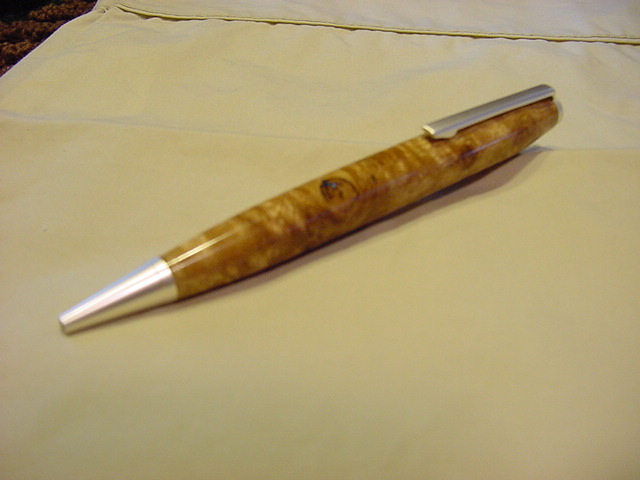

I tried your twist nib design, I like it , think I'll do some more. thanks for the info. sorry for the lousy pic.

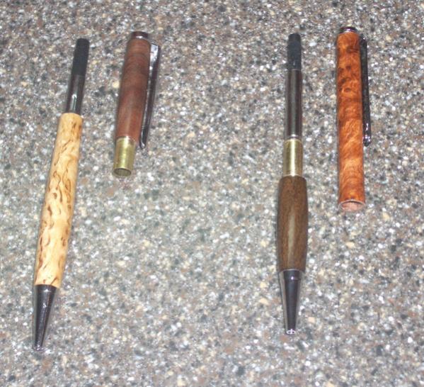

Very nice looking pens! I've been planning to play around with slimlines, but you've given me more ideas :). Looking at your first picture I was wondering how you got the split to disappear... wasn't until I read further that I realized you had moved the split all the way to the nib!
Out of curiosity, how do you handle the low/high splits? Does the brass stick out of one barrel and into the other or somesuch?

Yep the brass just sticks out of one end. Here's a pic. When I'm actually turning the pens, I put the pieces together on the mandrel. and when I am just about to size, I stop and twist the top and bottom 180 degrees. I don't separate the 2 pieces until they are ready to finish. This gives me nice even joints.
I've had several folks ask about these pens, so I was thinking of doing a couple of tutorials on how I did them.
One last thing, I've been talking to Cav about possibly starting a slimline challenge. The idea would be to find new ways to use the slimline kit. As soon as we have the specifics ironed out, I'll be posting a thread looking for folks interested in joining.
