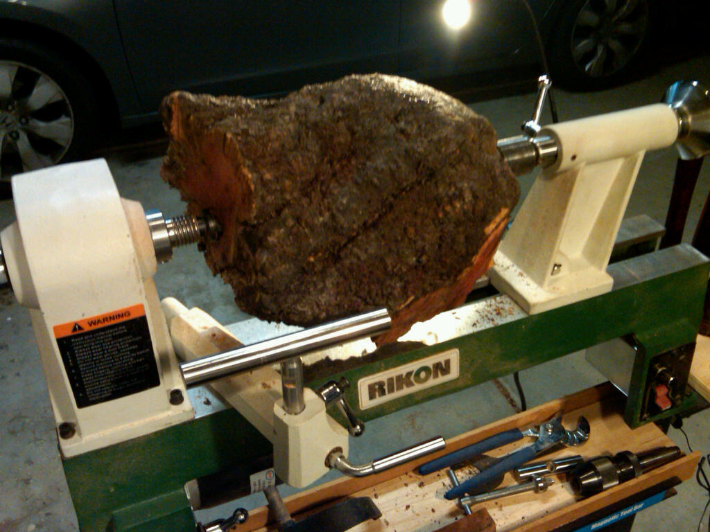

Here's the raw block with minimal prep with a chain saw (thanks Greg/Jay for the help):

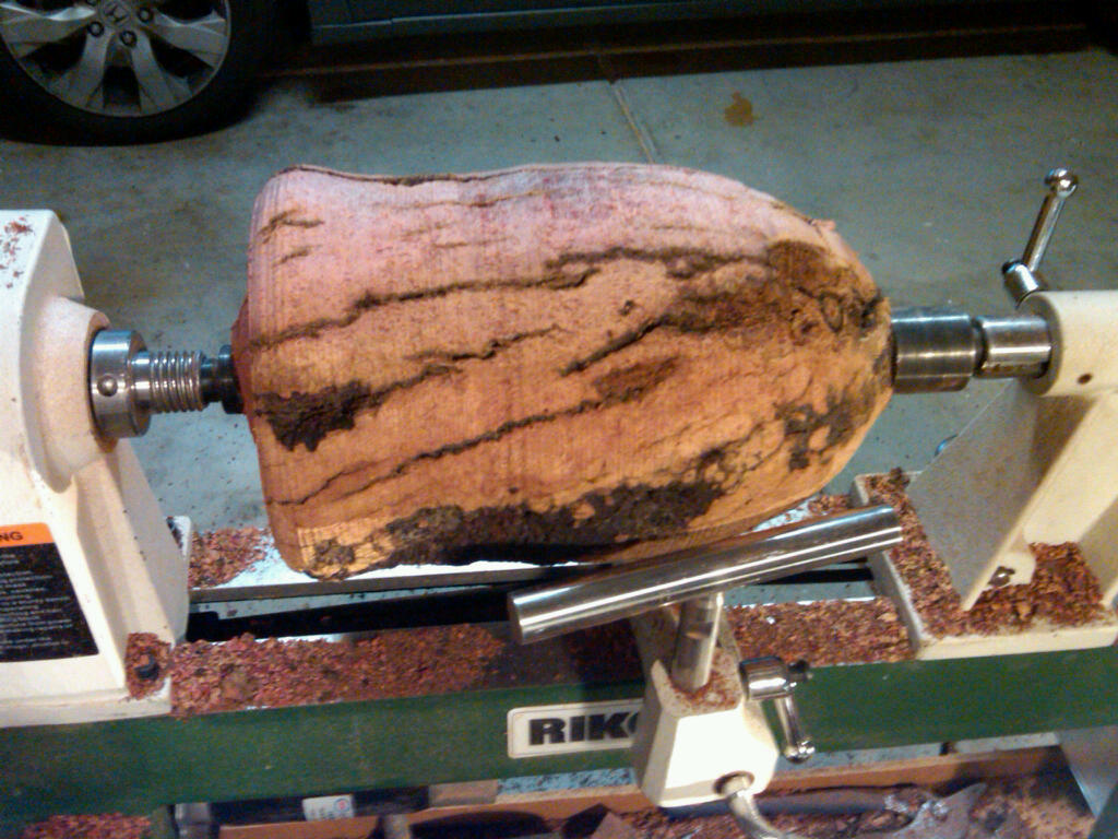

Turning the shape. As you can see it's filled with gaps and bark- but that's the look I'm going for:

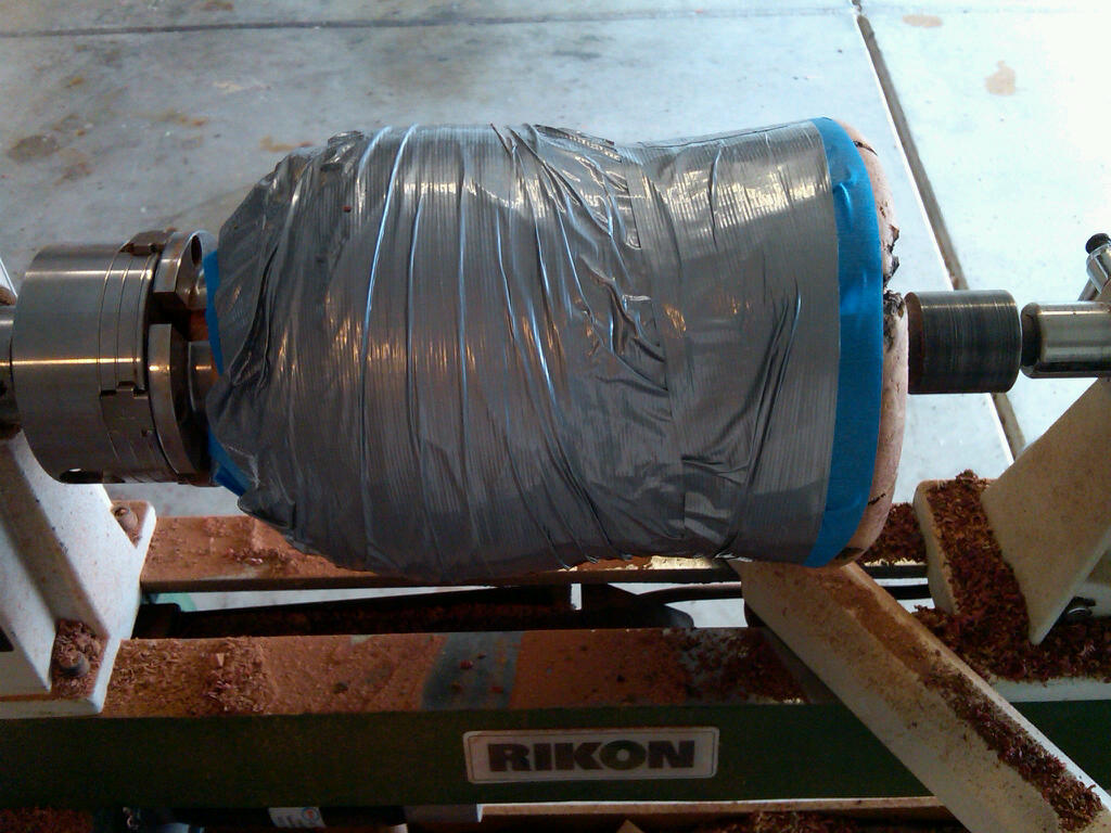

After I shaped the outside (and rested my weary arms) I wrapped it in masking tape and duct tape to keep it from flying apart as I hollowed it.

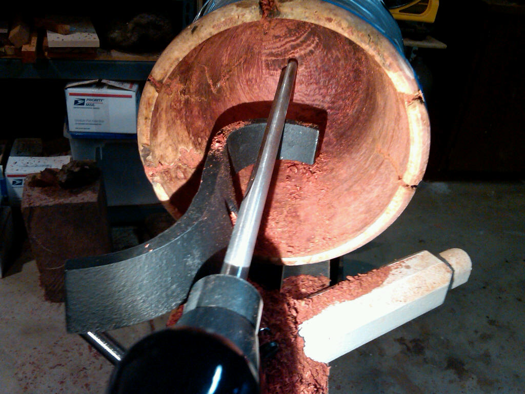

After a few hours of hollowing with the bowl gouge I'm reaching the limit of the depth before the vibrations are just too much.

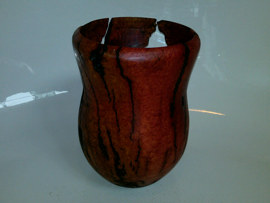

After a coat of Tung oil:

I used a Rikon 1216 lathe. I had about 1/2" swing clearance when I started. I was impressed that I never had a problem with torque/power while turning.
When hollowing I did have to put my weight on the stand to keep it from jumping around.

I thought you said you were a noobie! That is very impressive. Great work. Anytime you want to come out and visit or need more wood, let me know.
That is beautiful.
Nice job on a beautiful piece of wood! You've got to get some other tools before you go reaching into a deep form like that!
