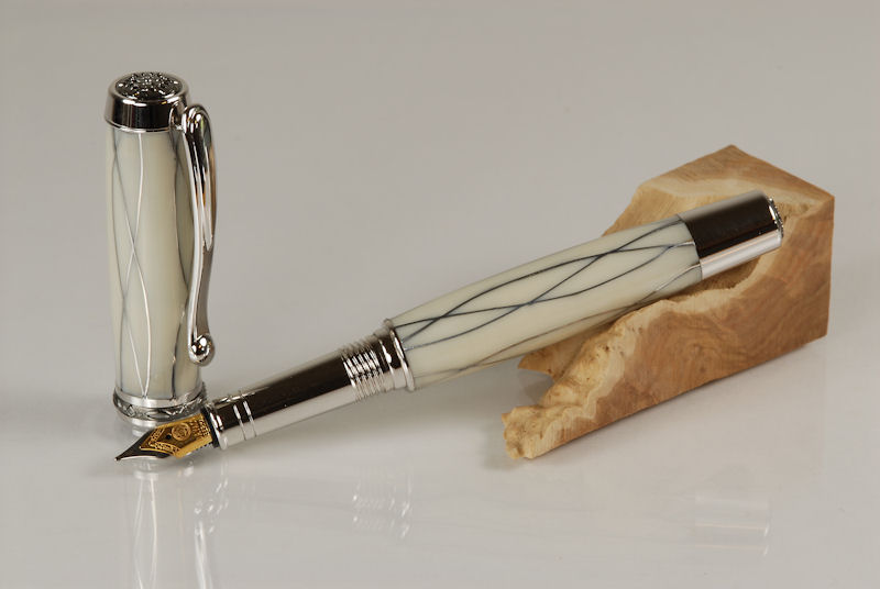

I made this pen using Alt. Ivory from Ed. I found the Alt. Ivory cut beautifully on the scroll saw. I don't remember any problems drilling or turning the pen.

Keith
That is one of the nicest pens I have seen. Great work on that one. I checked your site. Other great looking pens there. You have a PM
