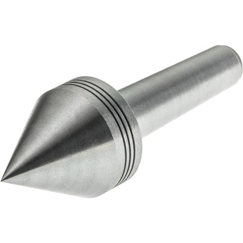

What is a 60 degree center?

60 Degree Live center that goes in the tailstock. You probably have this for your mandrel.
60 degree dead center for the head stock.

60° centers are the live center on the tail stock ends that go into mandrels. Most lathes come with a center for turning wood. The mandrel is metal and the dimple in the end is made for metal lathe centers. The wood centers tend to wallow around inside the mandrels.
That is what a 60° center is.
Now Part 2 to that. In the last three or 4 years JohnnyCNC has made bushings with 60° cups in it for using in Turning Between Centers (not using a mandrel). In this case, 60° centers are needed on the tail stock end (use with LIVE center) and head stock end (Use with dead center).
However, if one has the bushings for mandrel use, these can be used with just about any live center. Contrary to what most people will tell you, you do NOT have to use 60° centers for standard bushings to turn without a mandrels (TBC).
AS a reference to this, here is the first dead center that I made and used and posted here back in '08 and it was NOT 60°.
IAP Home - Photos - Imported Photo from leehljp
IF you use custom bushings and they are MUCH better than commercial ones, you WILL need 60° live and dead centers.
